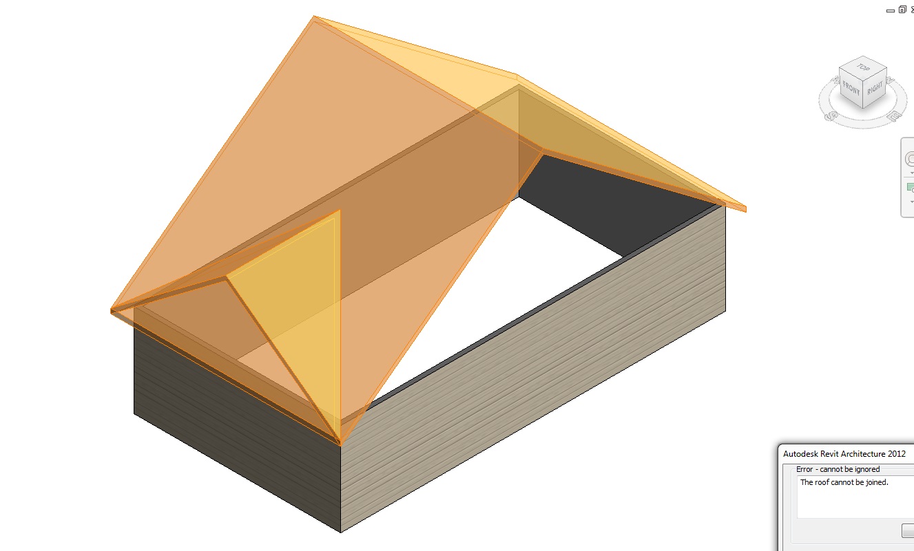

Is there a way to get the two join together to appear as the highlighted roof that claims it cannot be joined?
Mon, Aug 19, 2013 at 1:16:44 PM | Roof Joining Problems
They will not join.

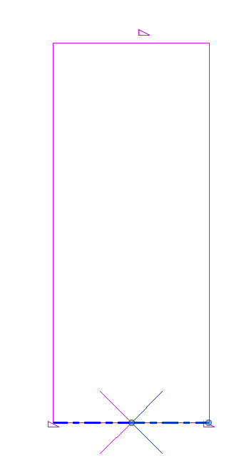

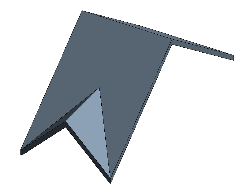

Do you really need the roof under that added gable?  If not, you can almost do this in one sketch.  You just need a tiny portion of main slope to do it.
Look at my plan and you will see how to do this.
Mon, Aug 19, 2013 at 2:02:27 PM | Roof Joining Problems
apeters
Joined: Fri, Jul 12, 2013
2 Posts
I got it! Thanks for the help.
