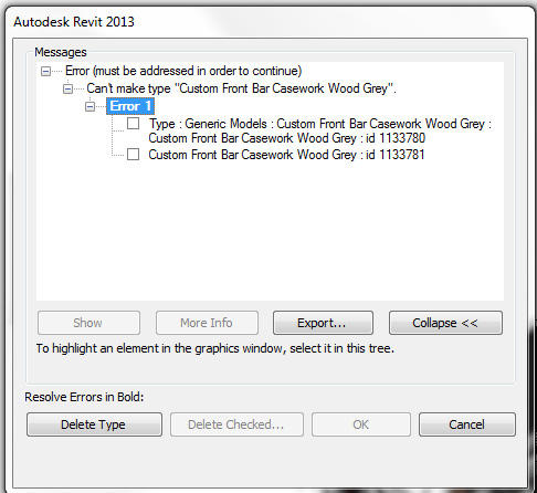

Greetings,
I have a project which has various pieces of casework loaded into it. I have built up a custom piece with side panels, counter top etc. I cannot remember what type of Family it was originally, It was made by opening a standard piece of casework already in the model.
When I try to load it into the project I get an error message.
'Error cannot be ignored - Can't make type "name of casework". See image for full message.
I have also tried copying it into a new family 'Metric Casework' and 'Metric Generic model' but neither seems to load into the project.
Any tips?
Using Revit Arch 2013
Many thanks,
CM.
Thu, Aug 15, 2013 at 7:36:39 AM | Casework not loading into project
Something in the casework family "breaks" because of the parametric settings for the type being loaded.  You need to open the family and "flex" it through the different types and find the problem.
