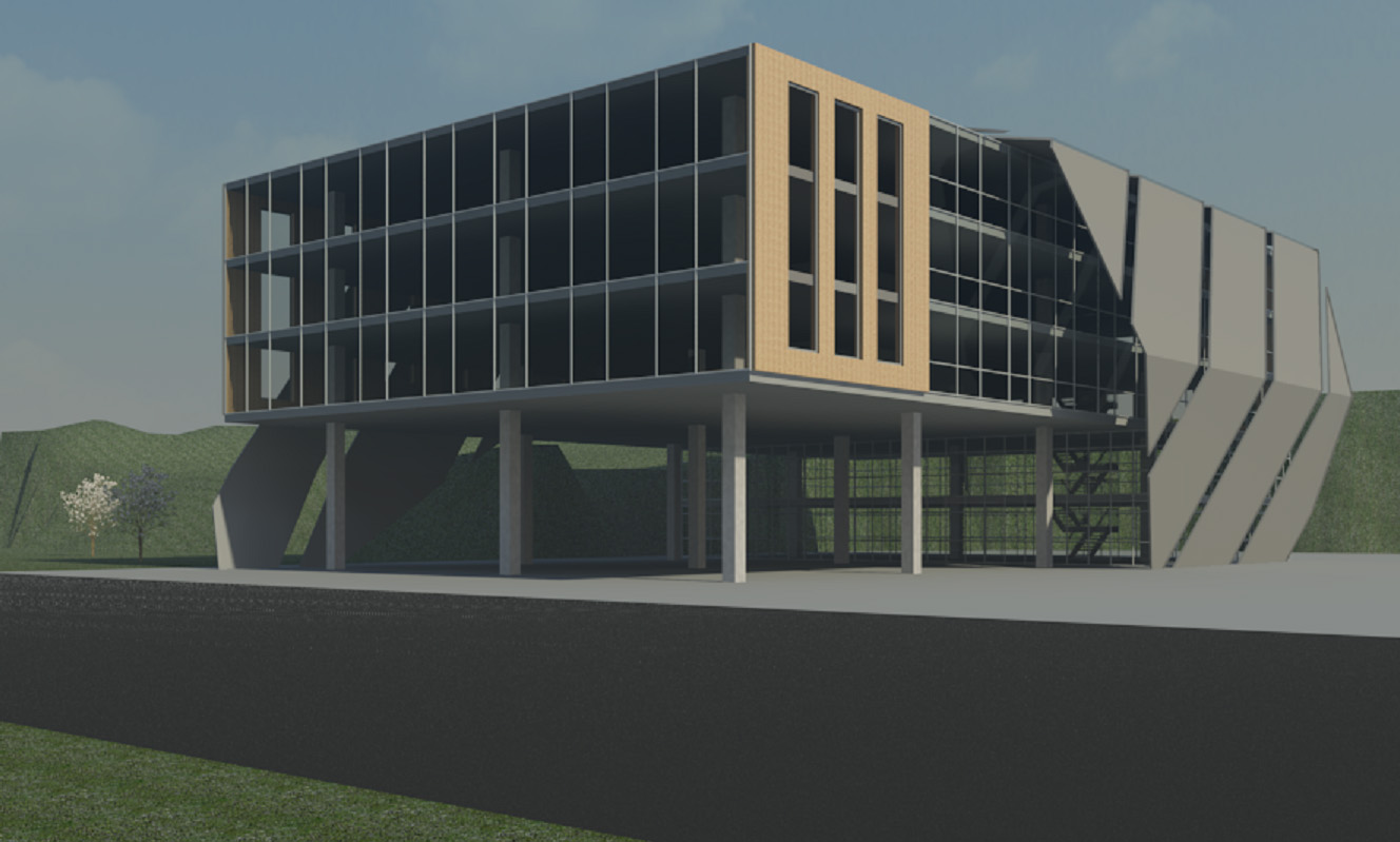

Hi, I am new here and pls someone help me on this problem.. I draw a model in place - type is roof show in attachment. The building is just normal Sqare design and the model I mention is that roof covering the building around. I want to change the roof model in place to curtain wall solar panel. where can i get the solar panel material? and If the type of the model in place can be changed , I want to change it into wall or something that's suit. Is there any .. method to change the type of the model in place after done? Please help me thanks.

Walls and curtain walls are system families with curtain walls being very special wall. You can do a model in place in the wall category but not a curtain wall.
