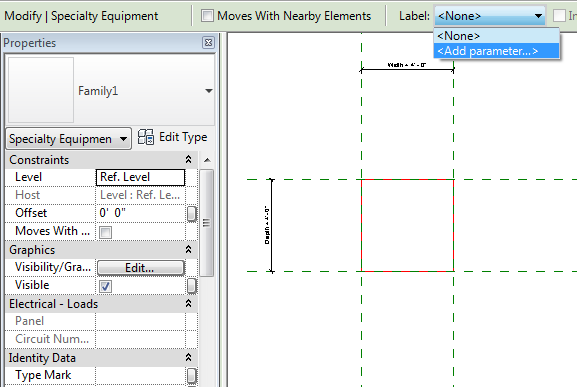

Hi, all.  Tried searching and found several threads, but none of them really helped.
In Revit Architecture 2012, I am building a line-based detail family for showing metal studs in section, at a parametric spacing.  Used for drawing wall details in plan or roof/ceiling details in section, showing studs cut through at a given spacing interval, with the last stud reversed so the closed side is toward the adjoining wall.  I have my first stud locked to a reference plane at the start, my last stud locked to a reference plane at the end.  There is a parameter for stud spacing.  The first stud is arrayed, with the array count being a formula of the line length divided by the given stud spacing.  Length is an instance parameter and depth / spacing are type parameters.
So far it works great, except for one thing.  I was hoping to make the stud size parametric as well, so I could do a variety of wall types within this one family.  I have tried this 2 ways, and neither has worked.
The first way:  I made a parametric detail family for the stud, which is a simple filled region with all the fixed dimensions locked, and the stud depth set to a label parameter.  I nested this as my stud object in the LBDF, and then loaded the LBDF into my project.  It worked fine at the default stud size, and I could adjust the spacing parameter at will.  However, there was no visible way to adjust the stud depth value of the nested stud family when using the LBDF in the model.  It used the default stud size of the family that I had inserted and I am stuck with that.
Second way:  I made the same LBDF except drawing a filled region directly in the LBDF rather than nesting the stud object.  I labeled the stud depth for the first and last stud, as well as the second stud in the sample array.  Once I loaded it into the project, this seemed like it would work, because the stud depth parameter was adjustable.  HOWEVER: the only stud that changed depth was the one at the end.  The others, in the array, remain stuck at the default size and don't repsond to the change of depth parameter.
Can someone point me in the right direction to solve this?  The first way seems like it would be better for file size, but whichever way can be made to work correctly is fine.
I could always make individual families for each stud depth, but I'd rather avoid that if I can combine them into types of one family.
Thanks for any help.

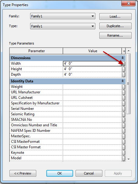

When arraying elements that need to be parametric it seems to work best with nesting families, as you tried to do.
There are a couple ways to make the nested families adjustable from the project.
1: Set up various types in the nested family, then in the main family assign a parameter to control which type is used (see pic #1)
2: Tie the nested families parameters to corresponding parameters in the main family (see pic #2)

@TKennedy:  Excellent, thank you!  It worked perfectly once I mapped the stud depth parameter through from the nested fmily, as shown in your first picture.  That's just what I was looking for.
I have a minor glitch in the spacing formula, in that it won't add another stud until the length of the last bay exceeds 1/2 of the stud spacing.  However, for the intended use, that's a minor issue, and I think I'll table that for later development.

I also meant to say your second picture above, not your first picture.  Thanks again.
