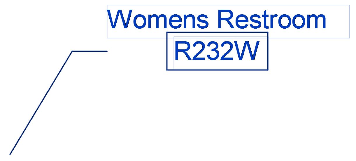

Our office standard for room tags is to have the Room Name and then the Room Number below it in a box (see attached image 1).  The issue I am having with the leader off the room tag is when the Room Name is longer then that of the box around the Room Number.  This leaves a gap between the leader and the box which is not aesthetically pleasing and can actually become confusing when on a plan if the leader does not attach to the tag (see attached image 2).
I attempted adding a line from the center of the Room Number box edge out to the maximum size of the Room Name as a visible paramater, but this causes a whole other set of issues. For example the varying size of the Room Name text causing the extension line that was added in to look way too long (see attached image 3).
Does anyone know of a better way of doing a leader for a Room Tag while keeping it parametric?

Thank you for your reply, but this video does not really help.  It is basically the attached image 3 from my earlier post.  Adjusting the shoulder to be centered vertically was an easy fix.
It seems that what I am wishing to happen with the leader line is not possible due to the fact that the Room Name may extend past the Room Number Box.  The way they seem to have fixed it in the video is changing the design of the Room Tag family to include a line across the entire family that the leader shoulder can start off of.  In most cases the Room Tag will be centered in the room, so a tag designed as a centered element is desired unlike the left justified version the video showed.
I have decided though to take the leader off of the Room Name instead of the Room Number box.  This seems to be a better fix.
Thank you for your help.

We do only allow so long of a Room Name before stacking, but it is still larger then that of the Room Number Box typically.
So there should be 3 different family types for a Room Tag.
1. Left Leader Room Tag (has an extension line for the leader shoulder).
2. Right Leader Room Tag (has an extension line for the leader shoulder).
3. Room Tag (no extension line, used for instance when able to be in center of room and when Room Name is smaller or equal to the size of th Room Number box).
It seems that this should work, just change the family type.  I think I made it more complicated then it needed to be.
Thank you.
