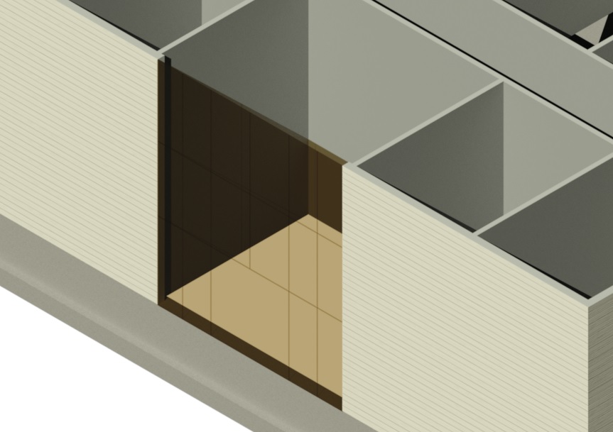

It seems I have answered my own question as it seems there is an important toggle under material editor.
Graphics allows transparency
Appearance allows  reflectance
So I create two materials
Curtain Wall Glazing which is transparent
Curtain Wall Spandrel which is opaque
Both these should appear in the image of curtain wall attached but in fact only one type is visible.
Why did this mistake occur?

The problem of rendered glass appearing to be all of one type.
This problem does not occur when graphic display options is set to shaded or consistent colours with edges but does with realistic or raytracing.  Any thoughts?
Mon, Aug 12, 2013 at 8:20:25 AM | Material options for transparent glass
If you need more types of glass, add more glass materials and add more than one glass panel type for your curtain wall.  Material is not an instance parameter typically.
