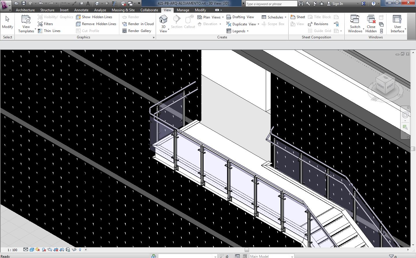

Hi!
I think this problem is very common in RAC 2013, and I'd like to give a help for everybody that's struggling with it like I was. Sorry if you find english grammar errors here, it's not my native language.
So, to better control the stringers of a stair I use the Railling tool, and add to the Rail Structure the profile that I need, in this case is a metallic beam. But we have better detailed posts about that.
The issue I was having is when the last slope is heigher than the others.

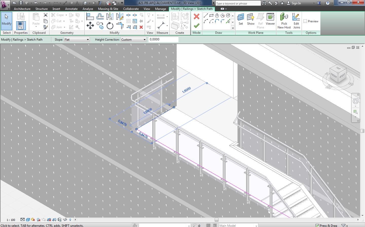

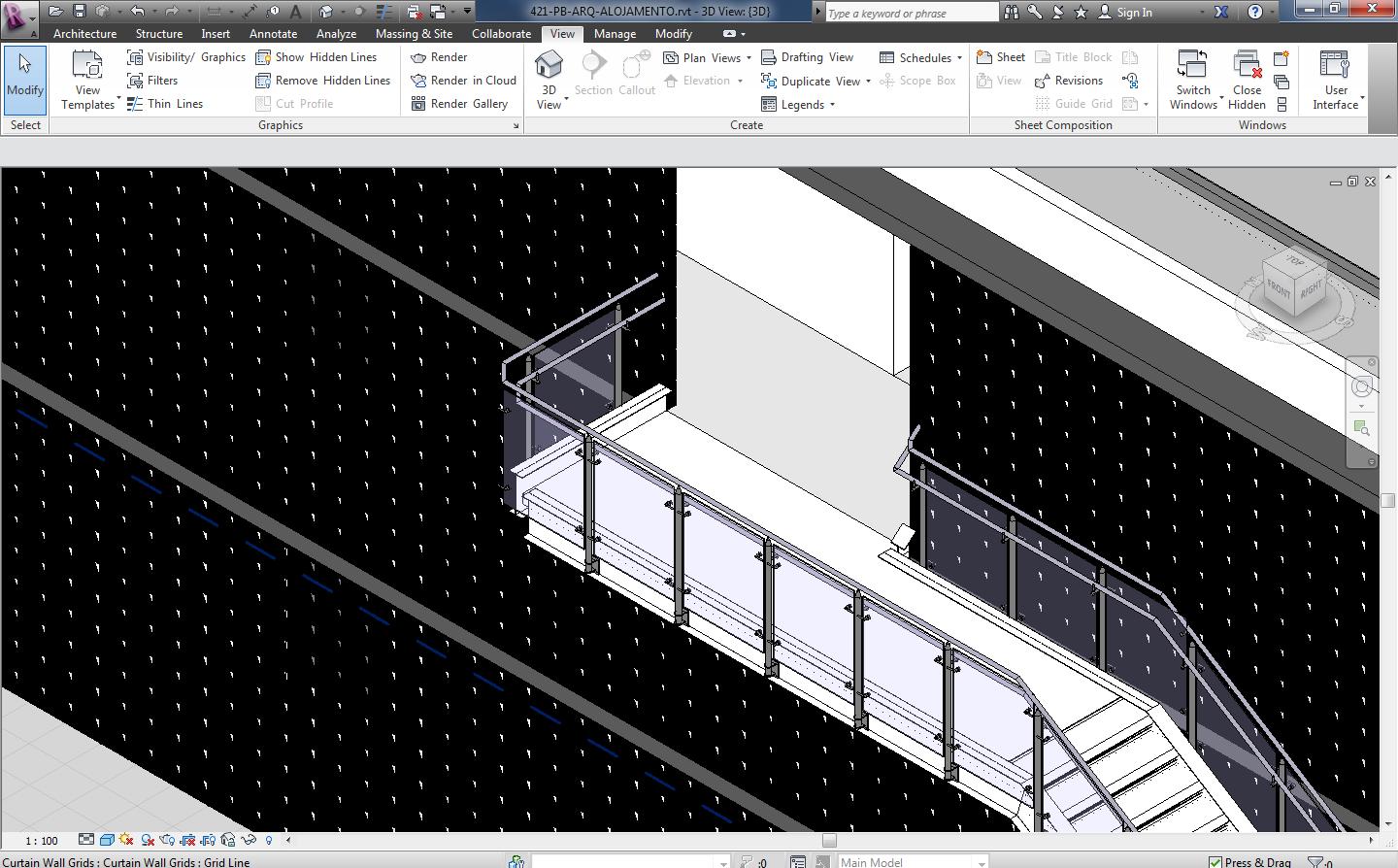

All you need to do is edit the Railling, pick the last line, and change the Slope to "Flat", and the Height Correction: "Custom 0,00" and the flaw is corrected. You could edit all the slopes, sometimes I do that, but mostly everytime the other slopes By Host are just fine (when you attach the Railling to the Stair using the tool Pick New Host).
Hope this helps!
