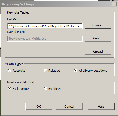

I'm trying to set up a keynote system that will allow me number the keynotes by sheet, and the input text for the keynote is different per sheet. Is there a way to do it?

Always look in your HELP - This is covered there.
Simple change the keynotes to "by sheet"

Is there a way to have multiple keynotes text file?
My company uses Coded Notes on the sheets and many times the information in the coded notes varies from sheet to sheet.
Wed, Aug 7, 2013 at 7:58:32 AM | KeyNotes
Only one keynote file per project.
You don't need seperate files, just more items.  So if your keynote file is:
