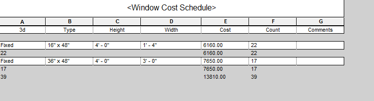

You can actually achieve this just by simply putting your own value into the Cost parameter in the schedules you create and without even using a formula. All you need to do is create a schedule with Count and Cost parmaeters. I would also maybe put the Family and Type parameter in as well so you know which window it is. Sort by whichever parameter you want, probably Family and Type so that it groups all windows of the same type together. Then be sure you set Count and Cost to Calculate Totals in the Formatting section of the schedule properties. Turn on Footers for each sort group and grand totals and you can end up with this right out of the box:
See the video for a step by step. HTH

Thanks guys you solved my problem, appearantly there is no database with cost values installed in Revit unless you get a plug-in from somewhere. Inserting it manually did the trick!
Thanks again WWHub and rkitect! (cool name by the way)
