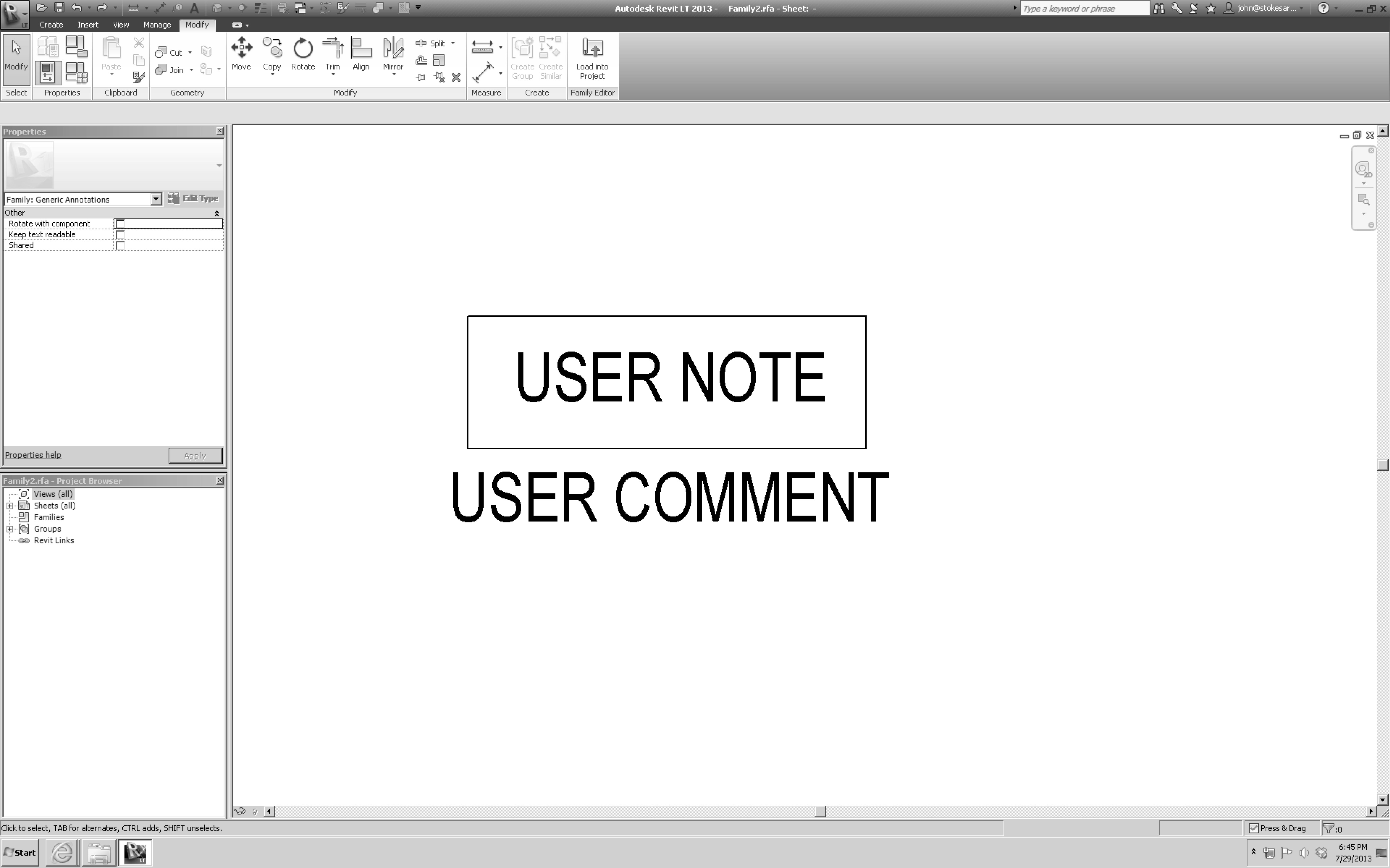

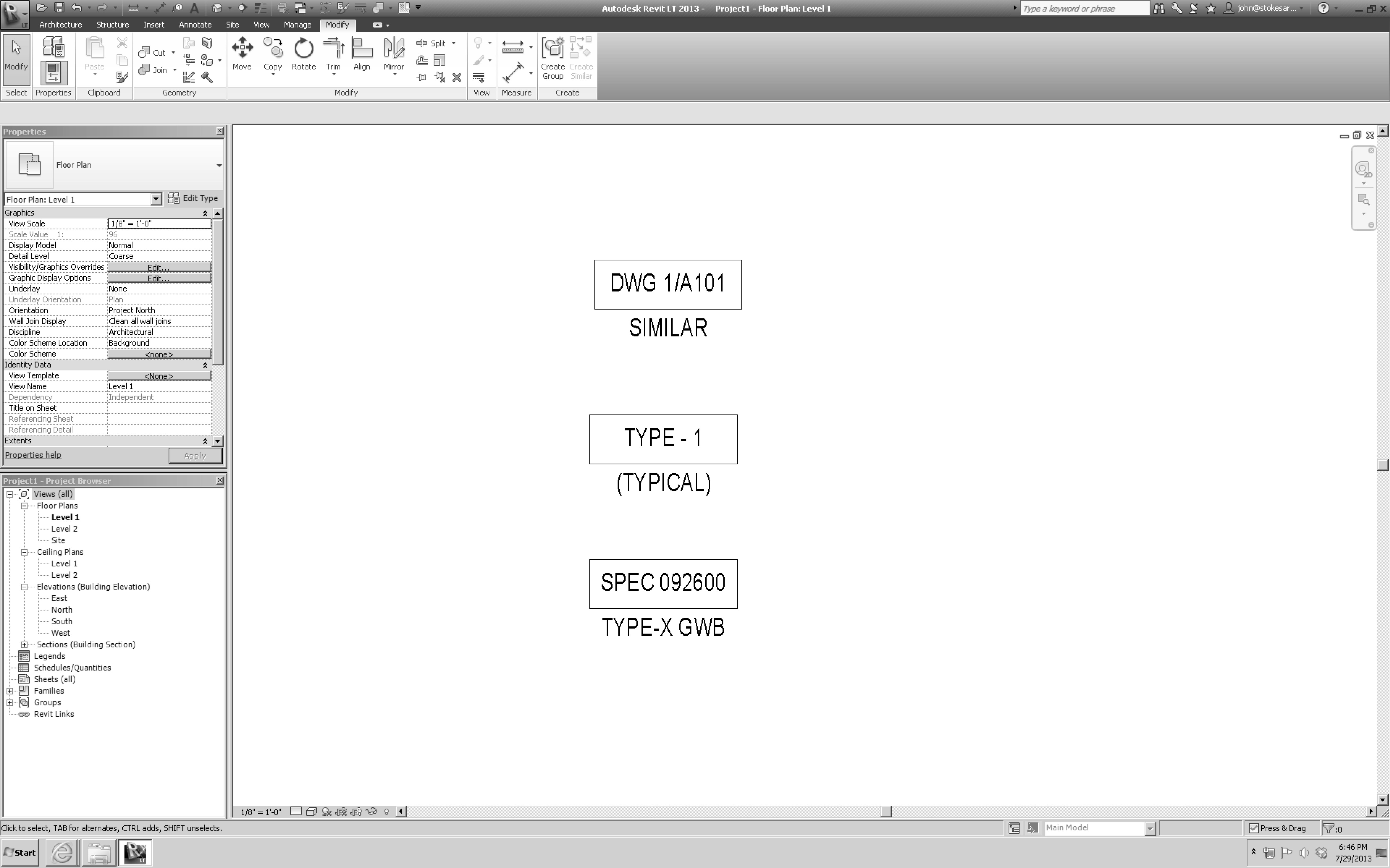

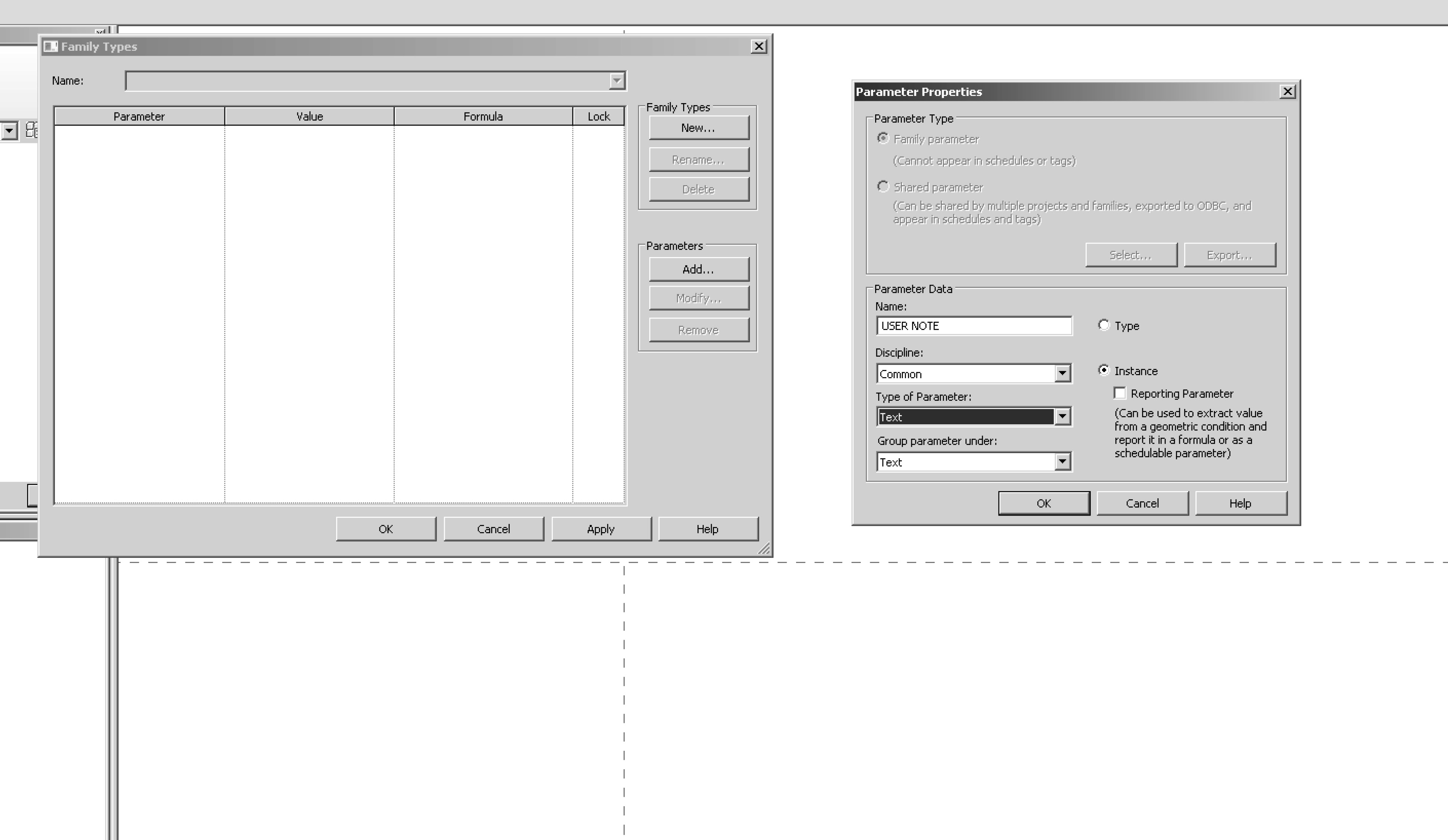

But if you MUST...  Create a new family using the "generic annotation" template.  Go into family types and create a new parameter.  Change it to an "instance parameter", also change the parameter type to "text."  Call it "User Note", or "Drawing Number"  any other name you see fit.  See jpg. below.   This would be the equivalent in cad to a block attribute (see my disclaimer, above).  Next place a label in the family in any configuration.  I created another parameter and label called "user comment" in the example below. see jpg. below.  Then load to your project.  The annotation behaves like an autocad block, with attributes.  You can change the values of the attributes either by double clicking on the text, or in the properties dialogue box, you will see the fields to enter the text you want.  See jpg. below, i used the same family to create three different instances.  This can be done in almost any way, to emulate elevation tags, keynote tags, or whatever, how they would function in cad.
