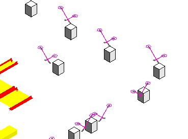

i can view the CAD files fine in autocad 2013, but when i link or import these CAD models their ducts/pipes do not show up in my Revit model (the bracing and other generic items from the CAD do appear)

the weird thing about this, is that a few weeks ago i could see everything fine when i linked these files but since i have tried to reload because of changes to the CAD model the ducts/pipes no longer appear (so as long as i dont reload the file the original still appears fine, but as soon as i reload the ducts/pipes dissappear). i asked the person who made the CAD files if they changed any formatting but they havent. so im guessing that i have changed something in my revit program. i have turned on every visibiltiy option and changed other view settings to see if it has any affect but nothing. like i said, i honestly believe that it was a system change either with my revit or computer. btw i have found a long fix: explode the model and do a polymesh conversion something, it works but takes forever with the file sizes that im working with.

i've tried the family fix. i open up a Generic Model and when i insert the CAD file (to try to save it as a family) the same thing happens and the duct/pipe do not show up.
(if my attachment worked...the 2 pictures shows how it would look when the duct/pipe used to show fine and how it looks now whenever i try to reload or just link)

everything in cad is there like it should be. in the pictures that i uploaded a few posts back, in the 2nd pic where the duct/pipe no longer show you can see that they have been replaced with generic boxes. (these cad files come from a client and this only happens some of the files and they have said they havent changed any formatting)

yea, i have opened up the files myself in autocad2013 and the files show fine. im going to try to have them export to ifc and then ill try to save that ifc as a revit file then link the revit file. fingers crossed

I had the same thng happen and I had to change the "PROXYGRAPHICS" to 1 instead of 0
and work fine
