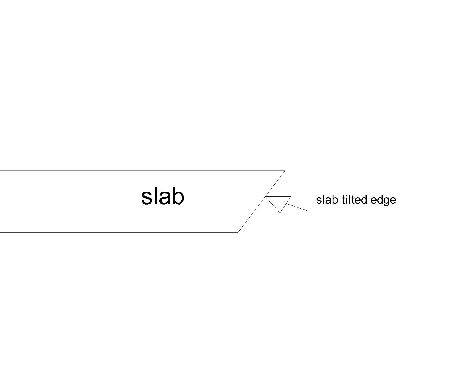

is there anyway to make a tilted slab edge .. like the shown on the attachement ...

try with Model in-place.
creat void sweep that follows original slab edge with Model in-place tool, and cut the slab with the void.

No need for model in place.  Just use a slab edge - under the floor pull down.  That can be positive or negative and will join correctly at corners.

That's right.  but i feel more comfotabe to use MIP just for cut something..
beacause after cut something, i don't have to take care about voids. they are invisible and no need calculation.

but how can i cut from the slab using the slab edge .... thank you ..

The last time I did this, I probably didn't do a negative but an added edge with a slope ... so an in-place void sweep (floor category) will work as dingohot says.

ya thats what i assumed  ... thank you anyway Smile
