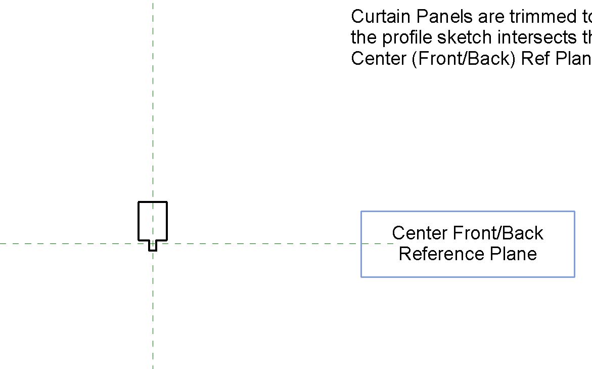

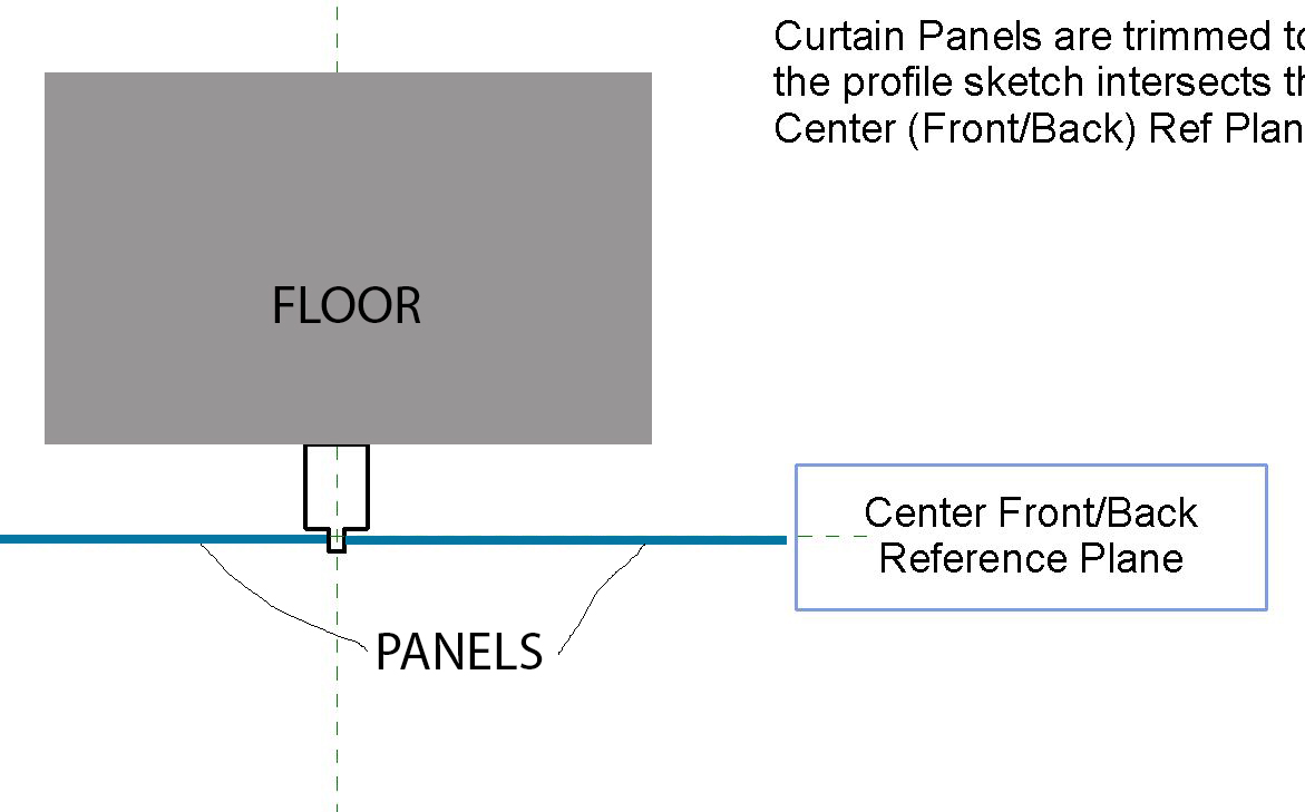

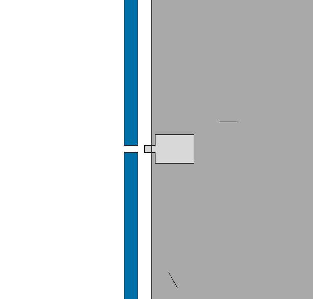

Im trying to create a custom mullion, follow the instructions in other topics but the panels appear far away from the mullion...
i also want the mullion to be at the end of the floor. (see attached)
im using Revit 2013
Anyone could help ?
Image 1 i what im doing. Image 2 is what is happening, Image 3 is what i want.
thanks!

Curtain walls have a location line.  Then the curtain wall panels and the curtain wall mullions have an offset parameter that you can change to set where they are in relation to that location line.  Adjust the offset of your mullions or your glass as needed.

where do i change those parameters ?
Thu, Jul 11, 2013 at 12:11:58 PM | Custom Mullion - Panels position
Why don't you click on one (mullion or panel) and look at the properties?  Easier to just look before you ask the question.
