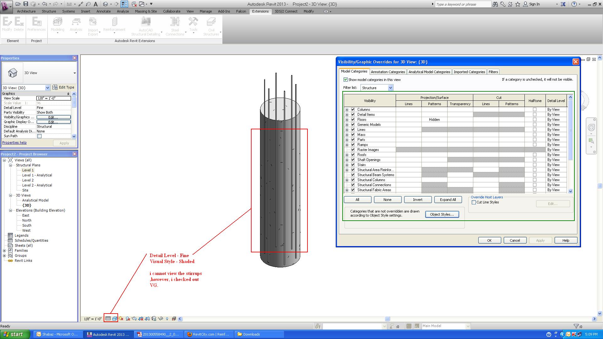

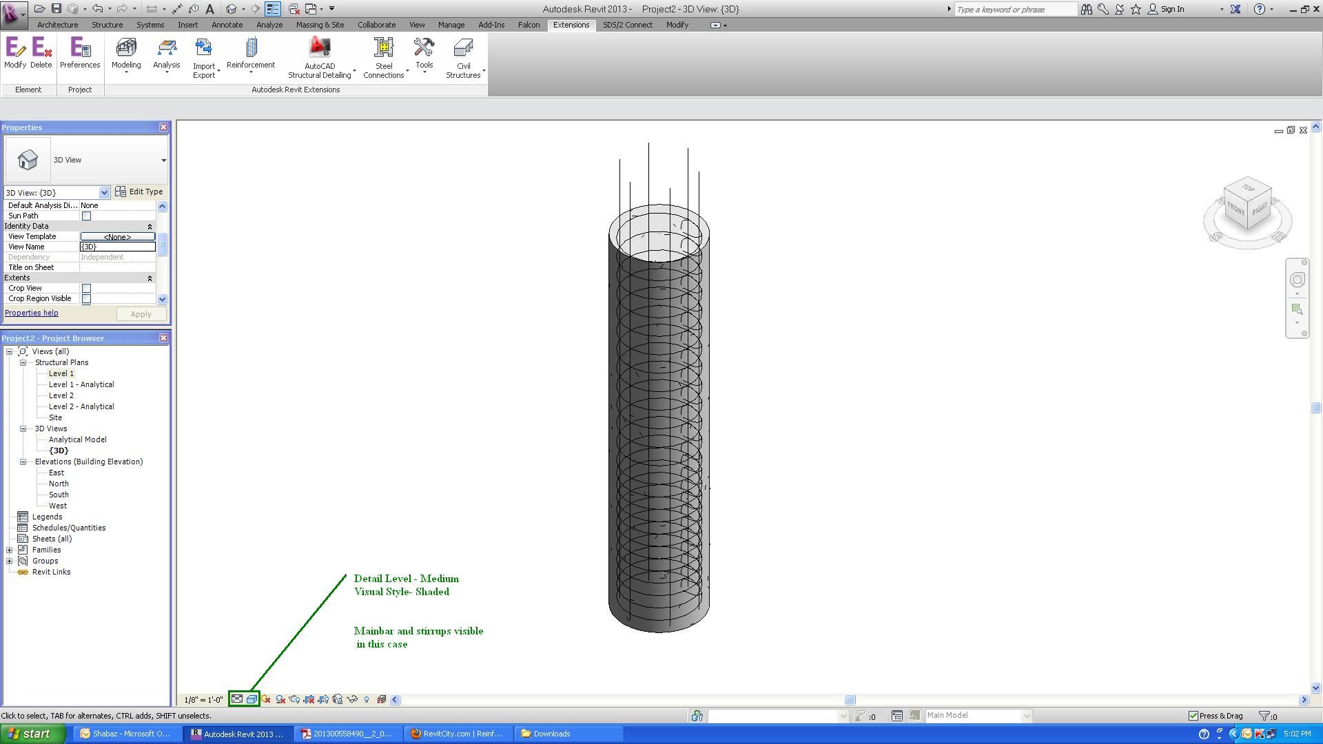

Thanks for the tip.but i figure out simple issue in revit extension 2013. i create a round column and select the reinforcement in extension,rebars is comes automatically, but my problem is ,if i change the VISUAL STYEL- SHADED  and DETAIL LEVEL - MEDIUM i can view the  main rebars and strirups. but i changed like this DETAIL LEVEL - FINE and  VISUAL STYLE - SHADED  i can't view the stirrups, even i tried VG also. how can i clarify this.
Please see the attachment.

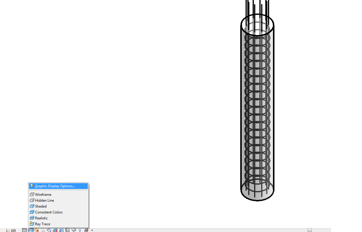

I think you just need to change transparensy in graphic display options. mine is set to 54 with fine and shaded.

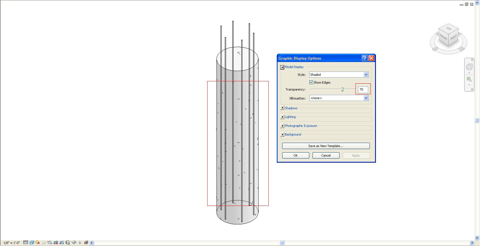

Thanks for your reply. but i have tried too (Grapic Display Option). it's not working... please see attachement
