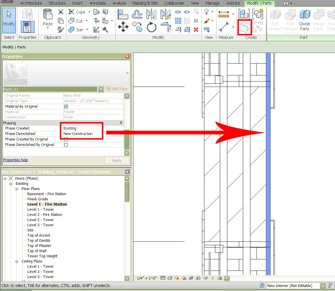

Hi Everyone.  I'm using Revit Architecture 2013.
I'm drawing an existing building and we are removing some of the existing finishes and replacing it.  I tried to use the parts tool to separate the wall finish from the rest of the existing wall and changed its phasing to be demolished.  When I looked at my demolition and new plans, the finish was still there.
Is there a way to fix this?  Also, was the parts tool the right tool to use in this case or should I just draw the existing wall and the finish separately?
Wed, Jul 10, 2013 at 12:44:05 PM | Parts Tool Issue
I would do this differently.  I suggest using a thin wall over your base wall with the two joined.  All doors / windows & openings will still work and you can demo to your hearts content.
