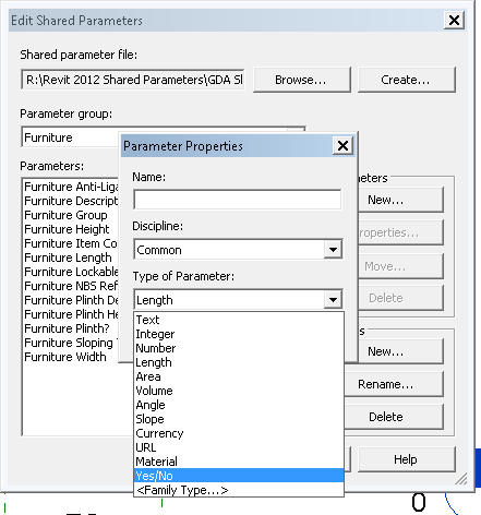

hello, i am using revit architecture 2012.
i am wanting to make a parameter in a generic model that is of the type left/right. just the same way you can do with a yes/no really. any suggestions?
i want it so that i can schedule the swing of a cupboad door
thanks,
kieran
Tue, Jul 9, 2013 at 7:40:45 AM | parameter types
Use yes/no
