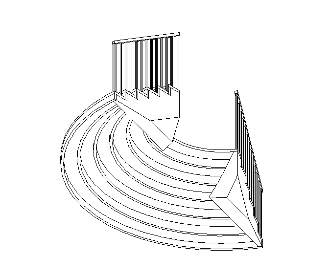

when i try to make treads curved in monopolic stairs, makes wrong cut out..

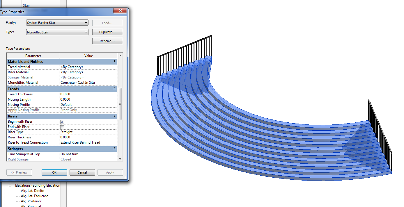

Put a value in "Tread Tickness" to solve that problem.

I don't think it's solving. Just hiding.

did you tried?

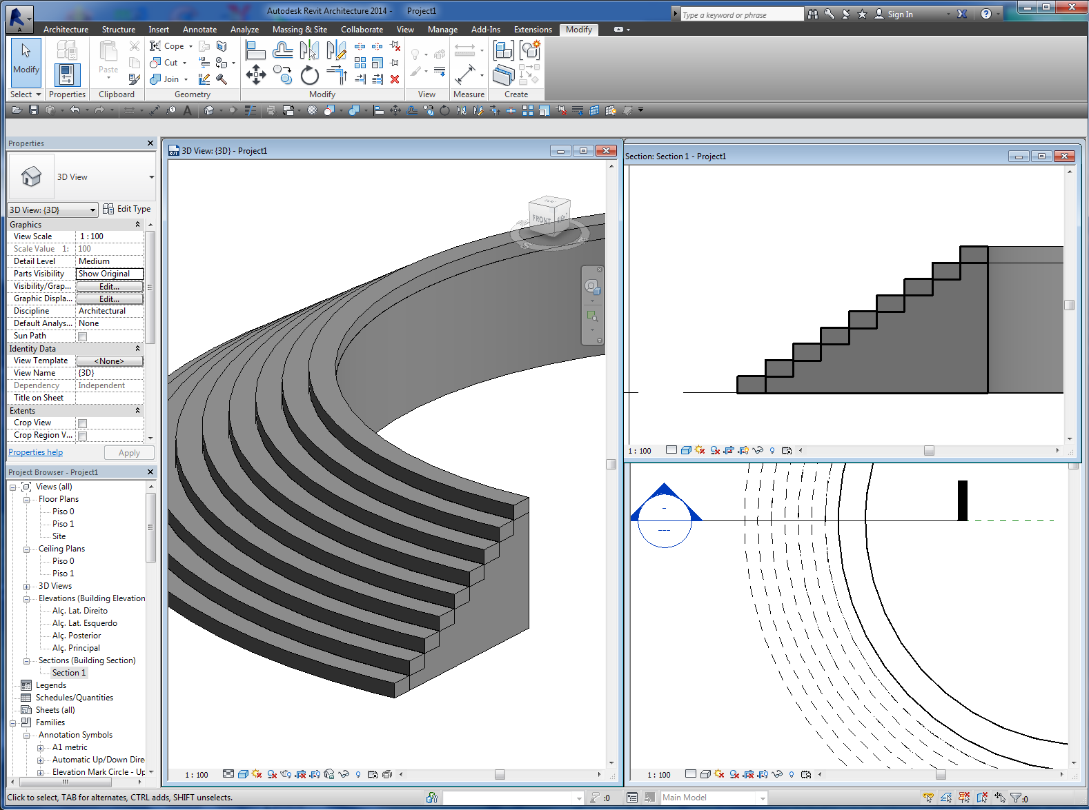

How about in section view?.. i think it's just covered..

I just tried AGAIN..
Like a said.. it's just covered...
I can't say this is fixed.
