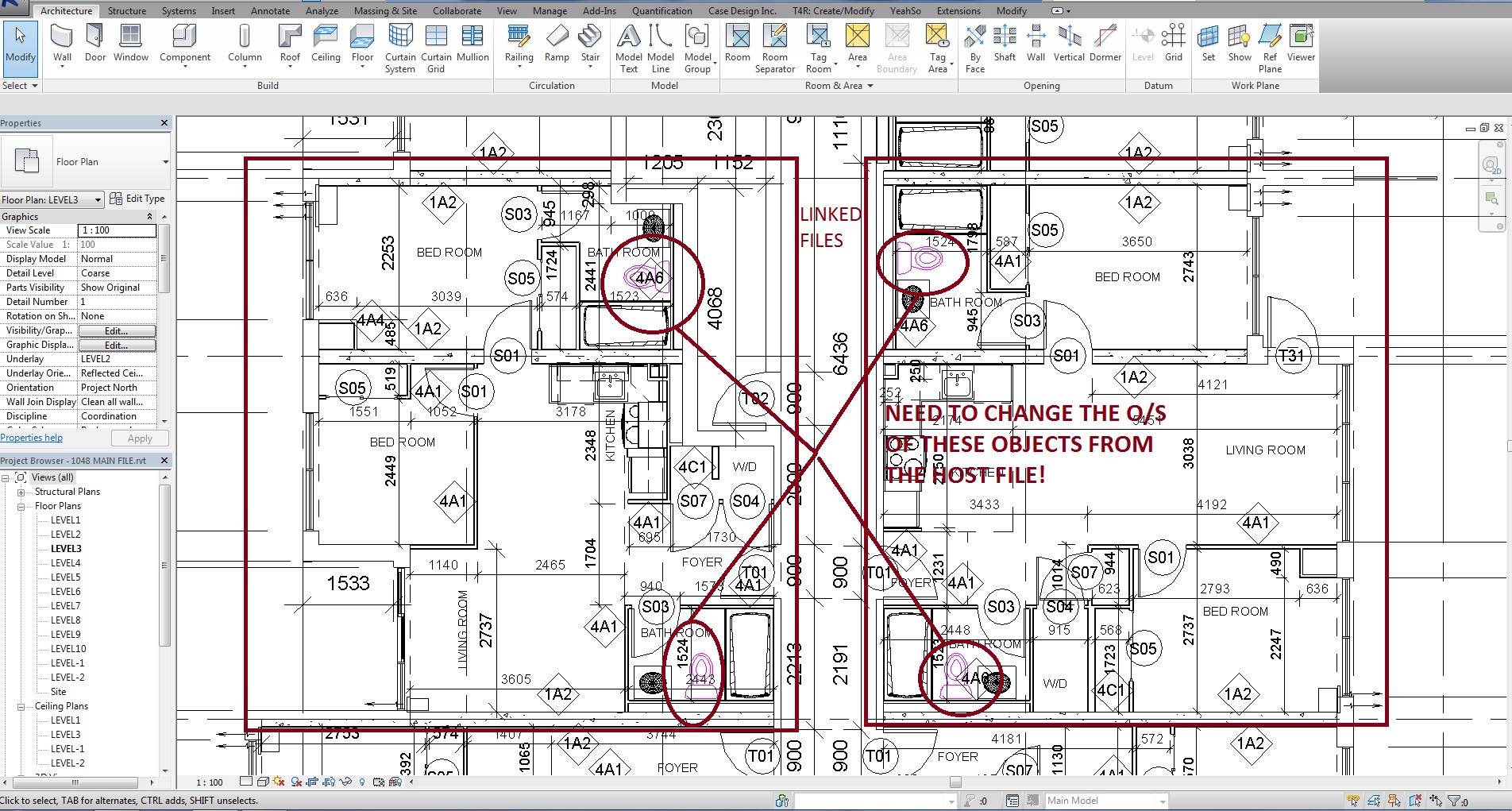

Hey guys,
I was wondering how can i control the object style of plumbing fixtures of a linked file from the host file.
The attached image shows the linked fileS from the host file and what i want to change.
Thanking you in advance.
Fri, Jul 5, 2013 at 8:40:52 AM | Linked object style
The object style of the project always controls all linked models by default.  You can independently control the VG of linked models in any view.  VG/Linked model tab/
Got it, Fixed it.
