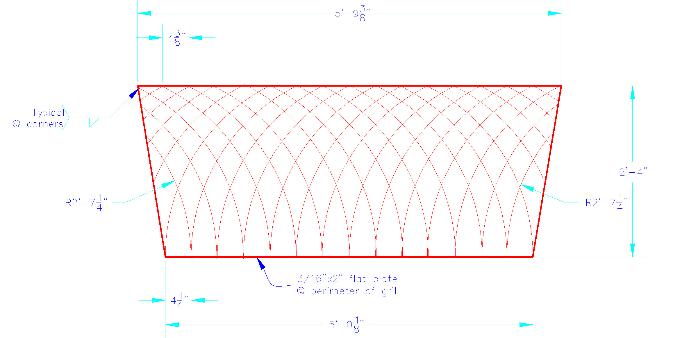

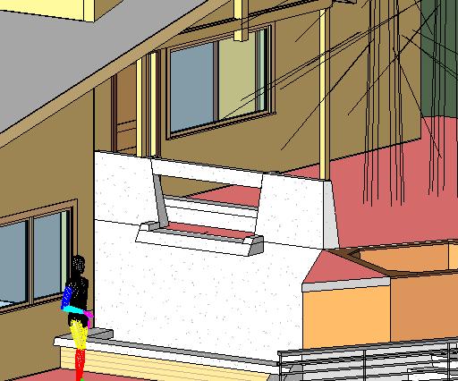

I have an elevation (2d) of a grill drawn in AutoCAD. I would like to imported it into Revit. I thought I could create a new family>Imperial Template>Baluster Panel.rft and import the CAD file into the elevation. The drawing did not come through. Anyone have insight into the best approach to create a 3d grill. It's going to have a concrete wall host, that I created with a solid blend mass. Thanks

Do it as a hatch pattern and give it a transparency of 100. I wouldn't recommend modelling the grille itself. You can then apply a material that has transparency mapping.

The grille is going into an opening in a concrete wall. So I don't think a pattern would works? I'm curious why you believe modeling is not the way to go? Thanks

setup a section that looks directly at the opening you wish to put the grille. Create an in-place family. Import your can file into the section "current view only". Set the workplane to the face of the wall to host the grille. Insert model lines in the section you created by using the pick command on your cad file. HTH.

Something is not working? I created a section as you suggest, facing the wall that I want to insert the grille in. Than I create an in-place family using the modeling tab. My section grey's out and I insert my dwg file with "current view only" checked, but it didn't show up. So I tried to insert my drawing file in the section without doing the "create family in-place" option and that didn't work either. I was able to insert the drawing into a drafting view but I don't know if I can insert the drafting view into the elevation and have it work in the model. Can you tell me what I'm doing wrong? Thanks Mr Spot.
