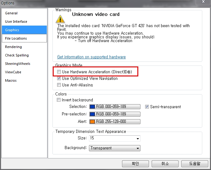

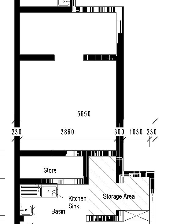

whenever i have existing walls and i pan around my project in plan view i get white lines showing through my walls. its not from detail level or visual style settings. my graphics card is good. so it cant be from them. its not a major issue because it still prints fine. just annoying. anyone know whats causing this?

try uncheck 'use hardware acceleration'

it worked. thanks
