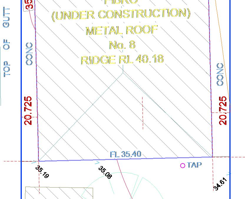

hi guys. ive done a few jobs where the existing building is at an angle to the site boundaries. when i come to do additions and alteration to it, it gets annoying, cause revit prefers to snap to perpendicular angles. ill normally angle some reference lines in the begining and use them as guides during the project. anyone got any better ideas to make things easier?
