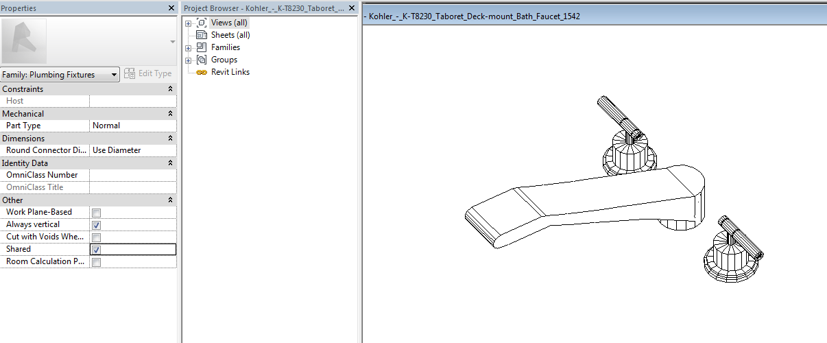

What does the shared check box indicate in Families? Thanks
Mon, Jul 1, 2013 at 7:31:56 AM | Shared Box in Families
If a nested family is shared, its properties can be scheduled in the project and the family exists seperately in the project and can be used elsewhere.
