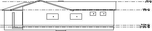

Windows in elevation are not showing detail only an arrow indicting slide direction. I've spent hours trying to solve this this. Attached an image

Change the view to "fine mode", if this not work you'll have to edit that window family and add the detail you want.
Fri, Jun 28, 2013 at 7:45:35 AM | Elevation View
Make sure your view depth includes the whole window.

Thank you so much - I was able to control it in the family editor under visibility settings.
