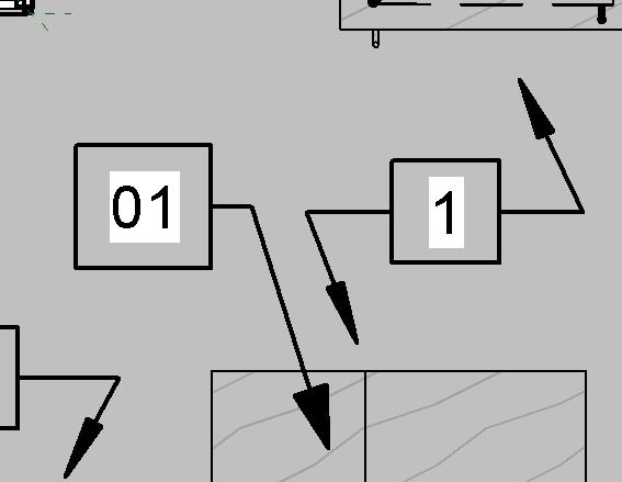

Is this even possible? I was trying the keynote tags to see if they would be a better alternative than the text boxes. But dissapointed to see there is no option to add extra leaders. Am I blind or did Autodesk think that won't be a problem?? Any help is appreciated.

Since all keynotes are hosted, that doesn't work.  When two items are close to each other and have the same keynote, we place a second keynote overtop the other keynote - it will basically snap into the same location.

Didn't refresh my screen to see Hub posted.  I agree with his statement

Yes I settled with the option to duplicate the keynote and overlap. Sorry if I misled, but the one on the right is the text box, just to show how I want it.  The Left one is an actual keynote tag. Thanks for the help !!

Do as we said!  Here is one of my keynote tags (2)....
