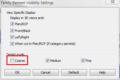

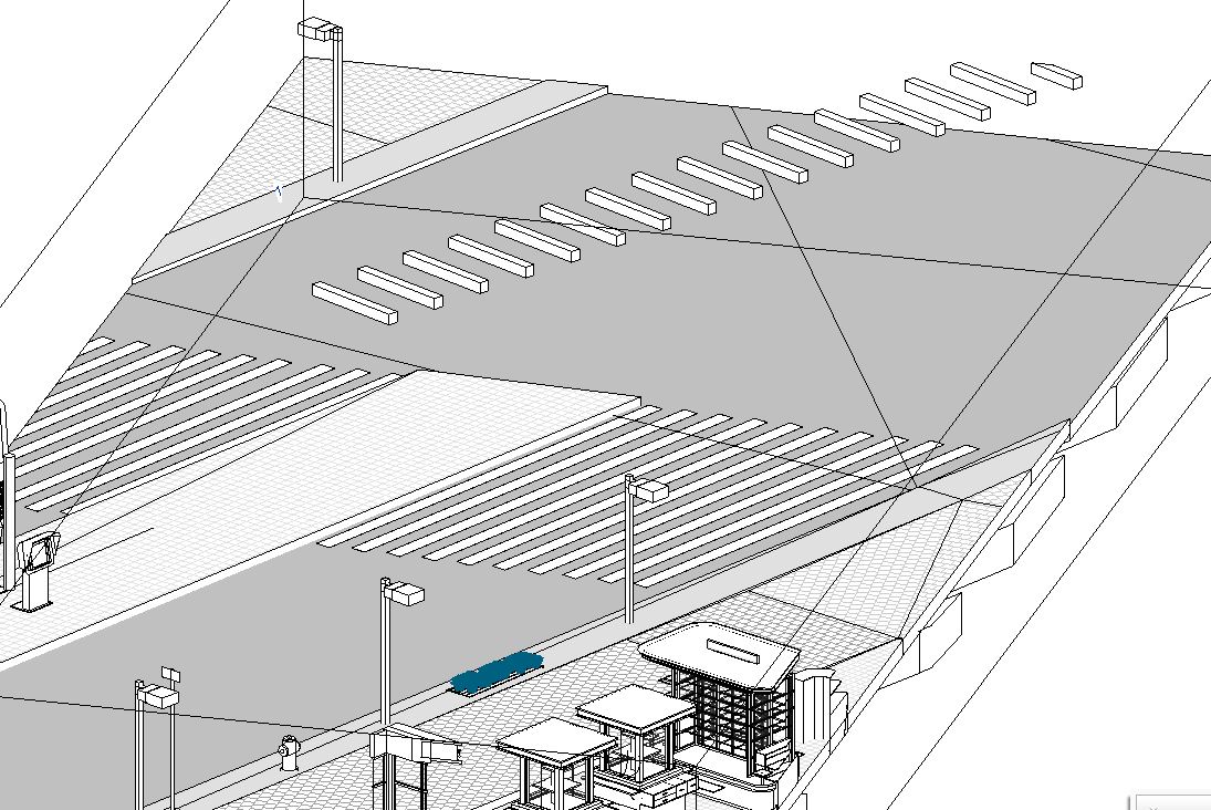

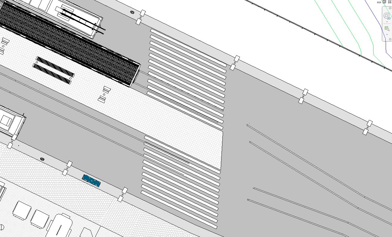

ive downloaded RAILWAY component from revitcity which is shown only in some views (like plans) but are always invisible on 3d views

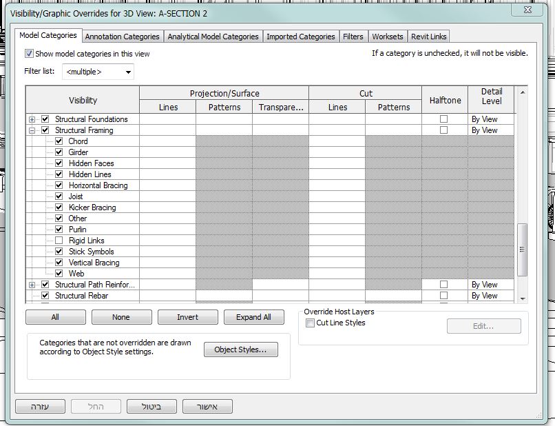

the rail family setted as STRACTURAL FRAMING so i checked visibilityqgrphics overrides window - for both 3d and plan views - and the V on stractural framing is ticked on both.
how shuld i enable view of the railway on 3-d  view?
btw i can see the rail Ties on 3d  view - BUT NOT THE TIRES (metal part)

check visibility setting of the rail..
