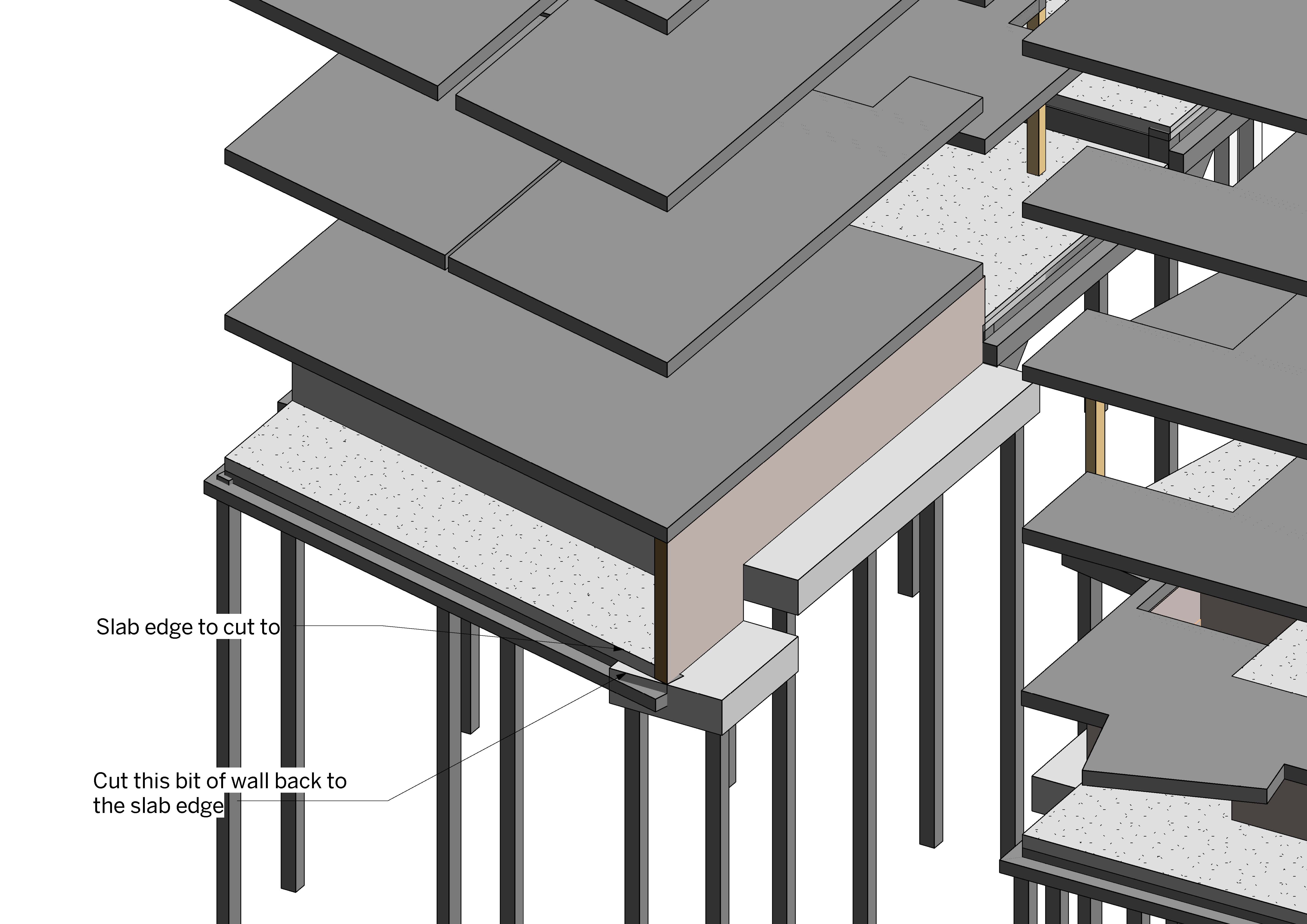

Hello there,
I’m trying to cut a wall back to line in with a slab, see attached, and I cannot figure out how to do it. Normally I would use a model in place void to cut with but I can’t get it to work. I feel that I’m missing an obvious trick here!
Does anyone have any recommendations? Any help is really appreciated thanks!

What you are pointing to does not look like a wall, it looks like an isolated footing to me.  What exactly is it?

Hi Teafoe,
It’s a wall with a sweep on the bottom to create the retaining footing with. Actually thinking about it I should have used a wall foundation but hey, I’m still learning and I was underpressure!
