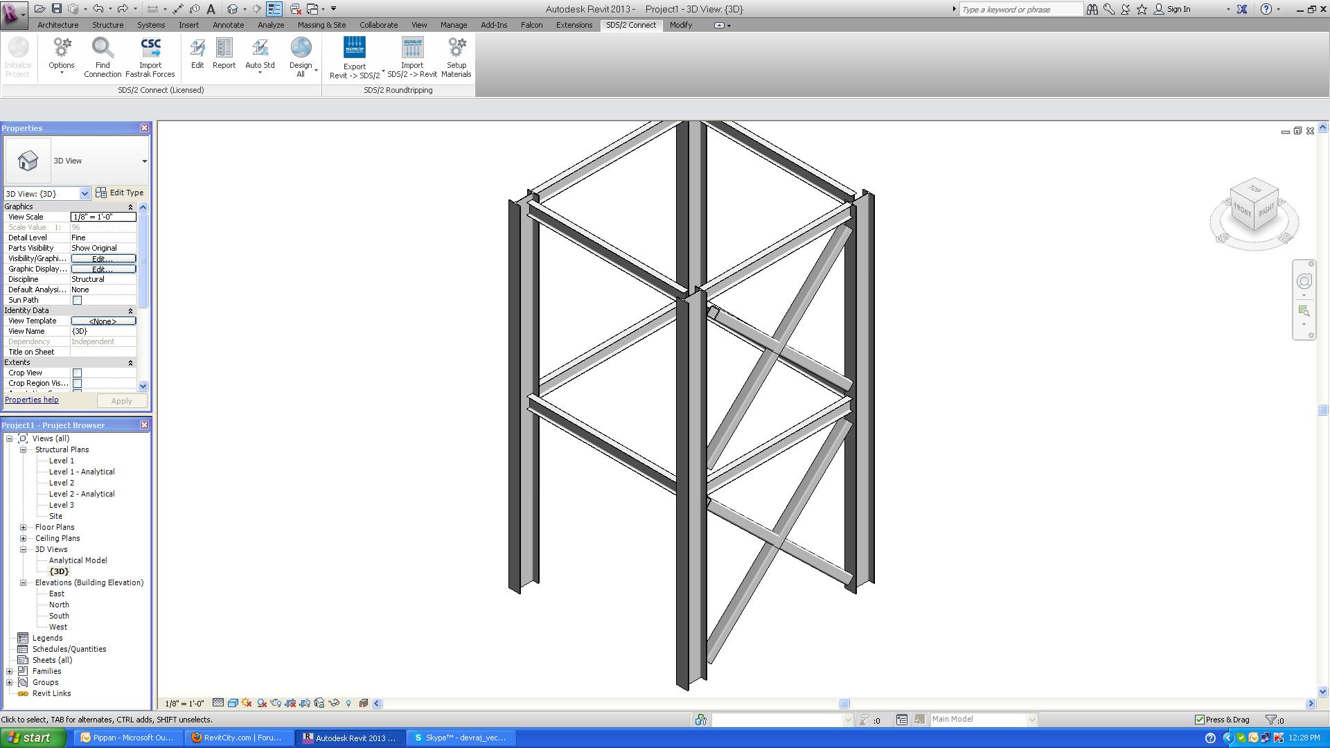

Hi,
i am having trouble with Vertical and horizontal bracing connections in revit structures 2013. i have been working on plugin SDS/2 connect too..please see the attached file for your better understanding....

This post and image tells us that you have a problem but tells us nothing about what the problem is

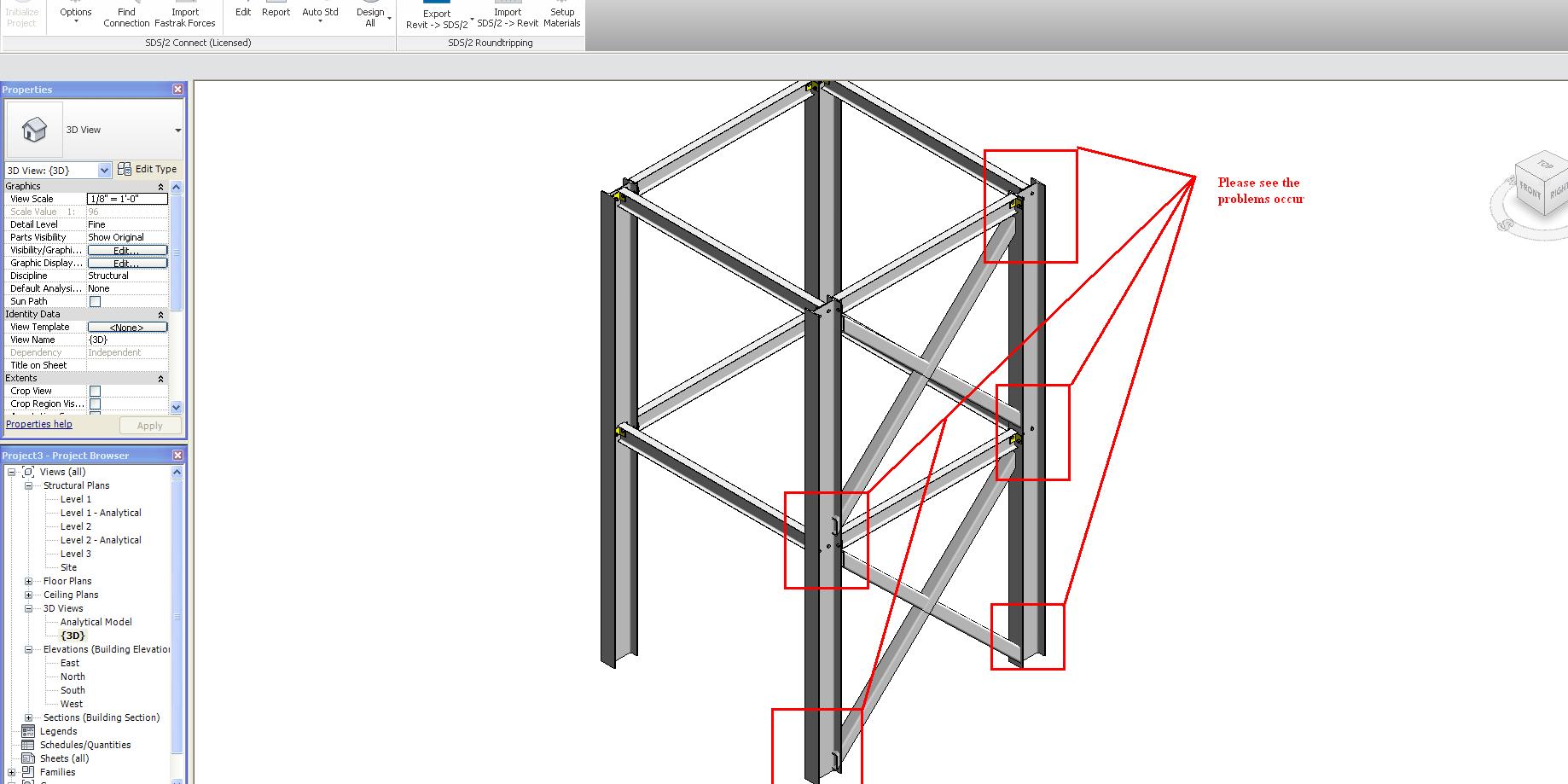

Sorry.... my Bad.... please see the updated one...

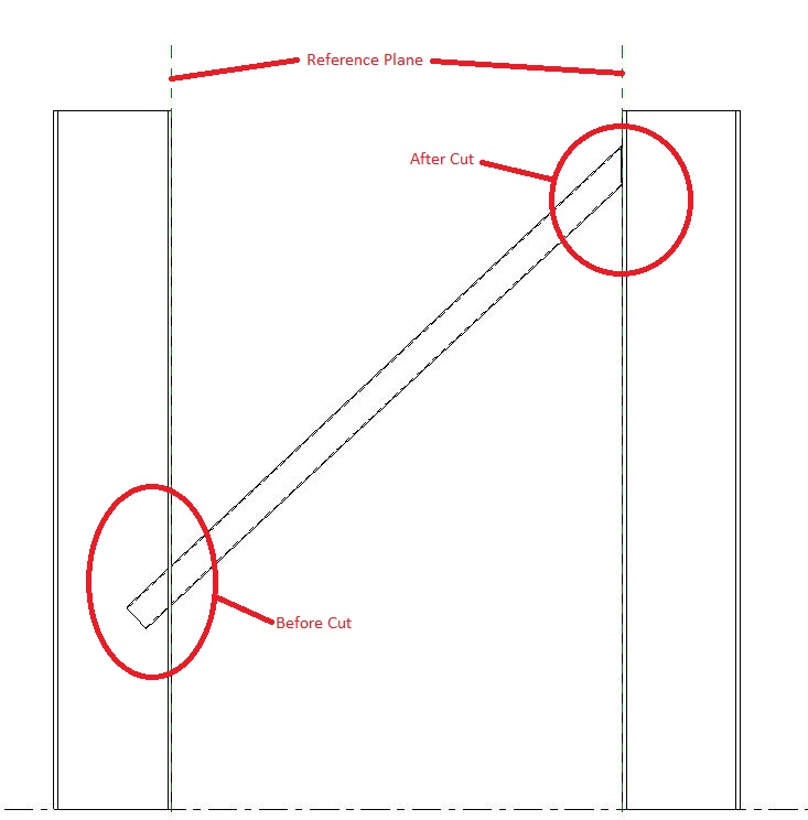

Did you place your bracing using the Brace command?  If so place a Reference Plan in elevation and use the Cut command then select the Brace then the Reference Plan and it will cut it to the Column.

Thanks for your reply.but i need only V/H bracing connections in SDS/2 (plugin) connect

If it is a problem with SDS you need to contact them for the information.
