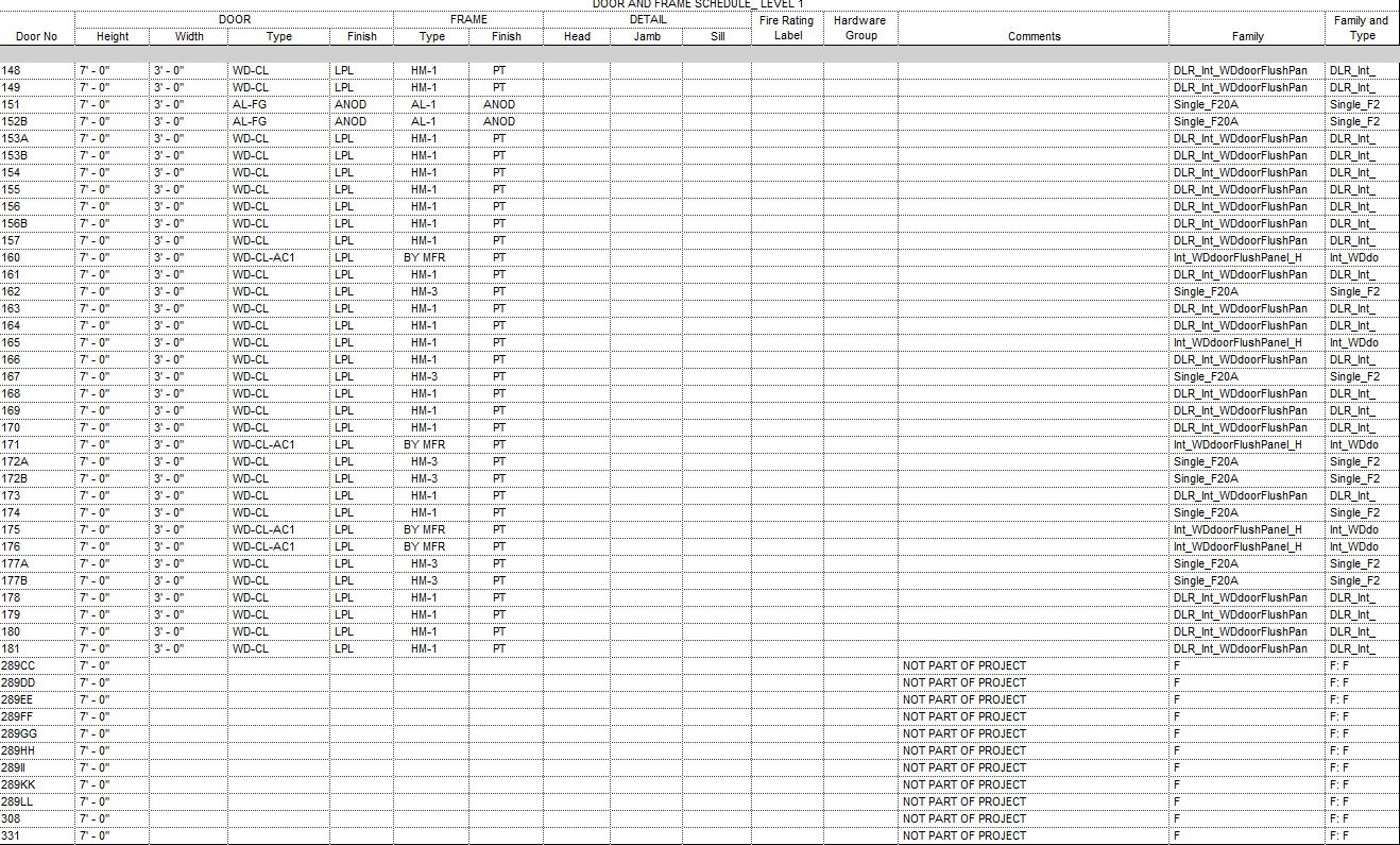

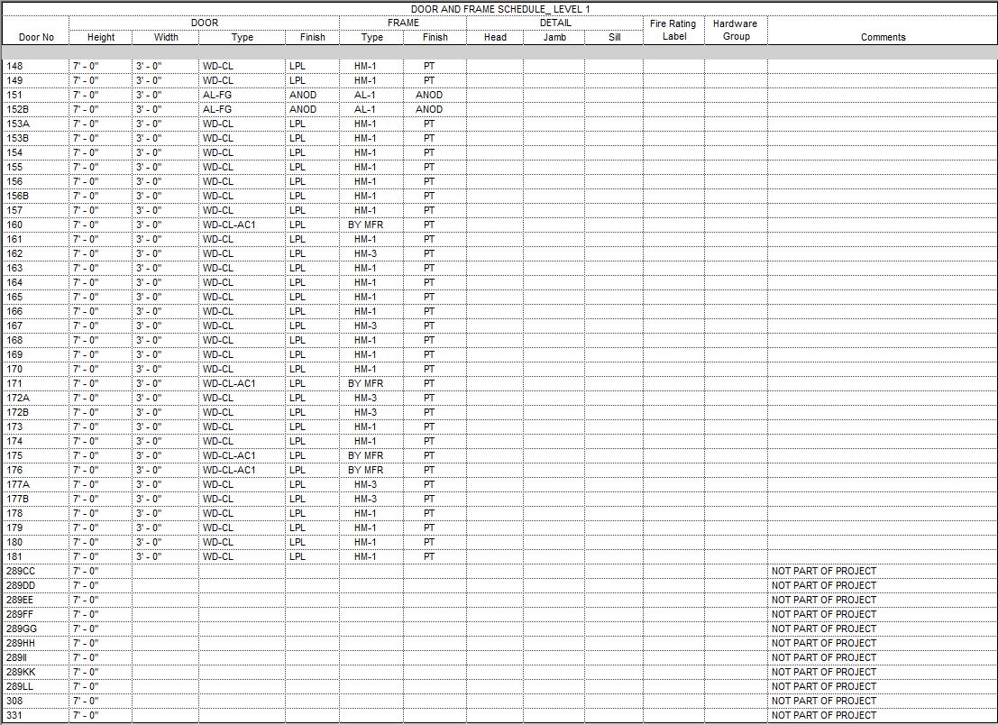

Does any one knows how to remove thes doors?
When  I delete them, revit keep replacing them,
Thanks,

Yes,
These doors they don't exist in the project
Fri, Jun 14, 2013 at 11:54:38 AM | Door and frame Schedele
They may be doors within other doors or other families.  If a door family is created and it has a nested family within it that is also a door family and that nested family is set to shared, then the nested family will show up in your schedule.
Add another parameter in your schedule - family name - and see what you have.

Nice tip, I'll add the family name parameter,
thx
Fri, Jun 14, 2013 at 1:41:59 PM | Door and frame Schedele
franchevich
Joined: Tue, May 29, 2012
12 Posts
yes it looks like there is another family nested right? see attachement
Fri, Jun 14, 2013 at 1:44:08 PM | Door and frame Schedele
franchevich
12 Posts
I need to remove this F type door now, any tips?

Can you filter by Family F
Fri, Jun 14, 2013 at 2:17:13 PM | Door and frame Schedele
#9
Pick one in the schedule and and pick "show".  That should show you what family it is nested in.

The bugging door is a nested door panel called out as a door,  Sad

The solution for this issue it was to remove the nested door panel from door family,
