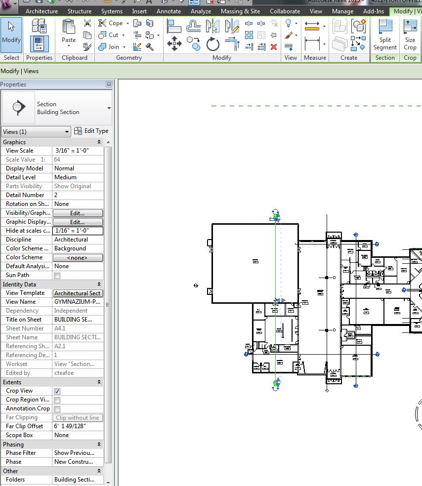

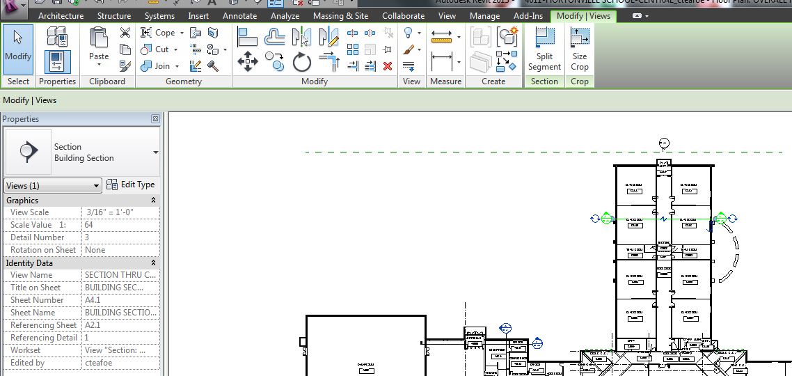

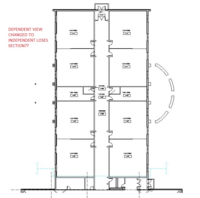

I have a FP view I created as a depended view, I cut my sections in the views then I created my Reflected Ceiling Plans and added ceilings. I decided I didn't want my FP views to be dependent anymore so I changed them to indepentent again.  For some reason I can't see my section cuts I created earlier on the RCP and when I go to my section view I don't see my ceiling that I put in. However if I create a new section I see the section in my RCP and my ceiling in my section like I want.  Whats going on?  i'm assuming it has to do with creating my views as dependent but not sure??
I just noticed that the sections show on my overall plan but not on my independent views.. this must have happened after I changed them to independent, is there a way to get them to show in all views again?

It has nothing to do with creating your views as dependent or not. There is a difference between plan views and detail views.  Also, your section cuts can be set not to show in views smaller than.....

I am so confused, maybe because its Friday.  They are both plan views, I created them all the same way.  The plan where it shows is 1/16" the one where it doesn't is 1/8" so its not hidden.  I just saw another thing.  When I click on the section I don't get any options for it, like its locked but if I click on other sections they are fine?  I must have something messed up.

Wow happy Friday.  Someone created a section cut referencing another view, hence why I cant change anything.
