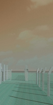

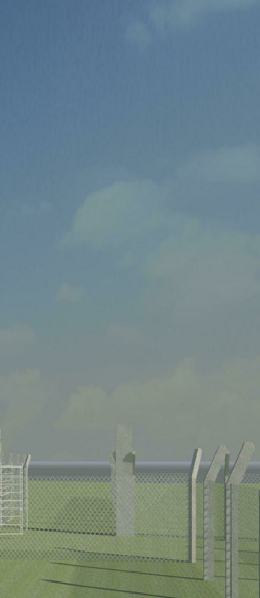

Images I have already rendered previously are appearing with the colours all wrong as shown in examples. I think I must've changed a setting without realising as it's the same in all projects and on different computers. Any ideas please?

What did you change?  It could be a lot of things.  Is this just a rendered sky and not an image that you put in?  What do your Rendering settings look like?  Did you adjust your Exposure in the rendering dialog box?

Figured it out, Windows update problem.

Thanks teafoe5 have only just seen your reply. Needed to turn off Hardware Acceleration after a Windows update.
