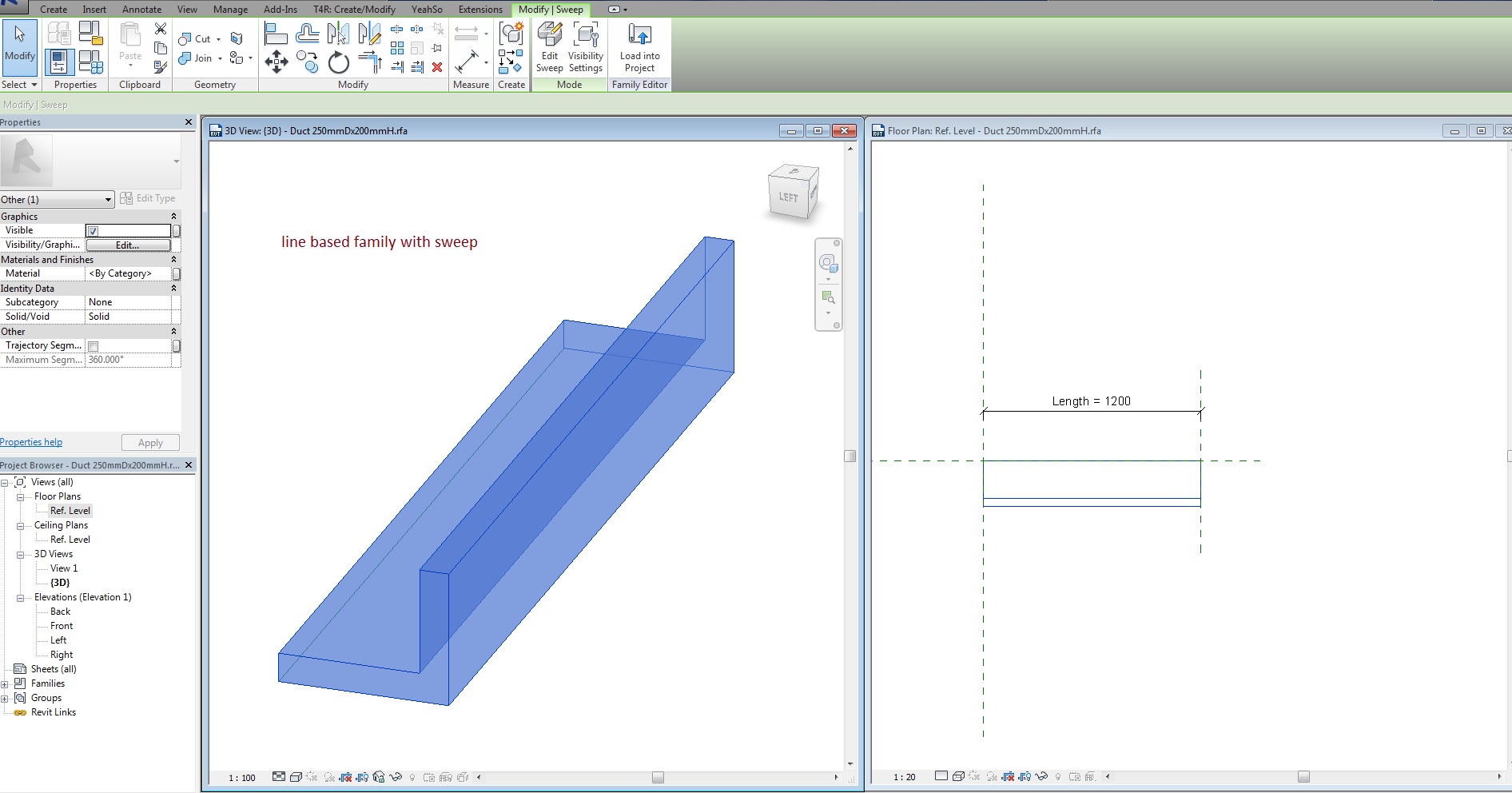

I want to create a bulkhead (to contain HVAC ducts). So i thought I may create a family (line based), and have a sweep in it so i can create the bulkhead on the plan by choosing lines.

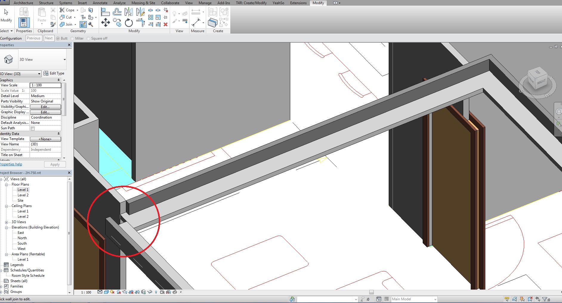

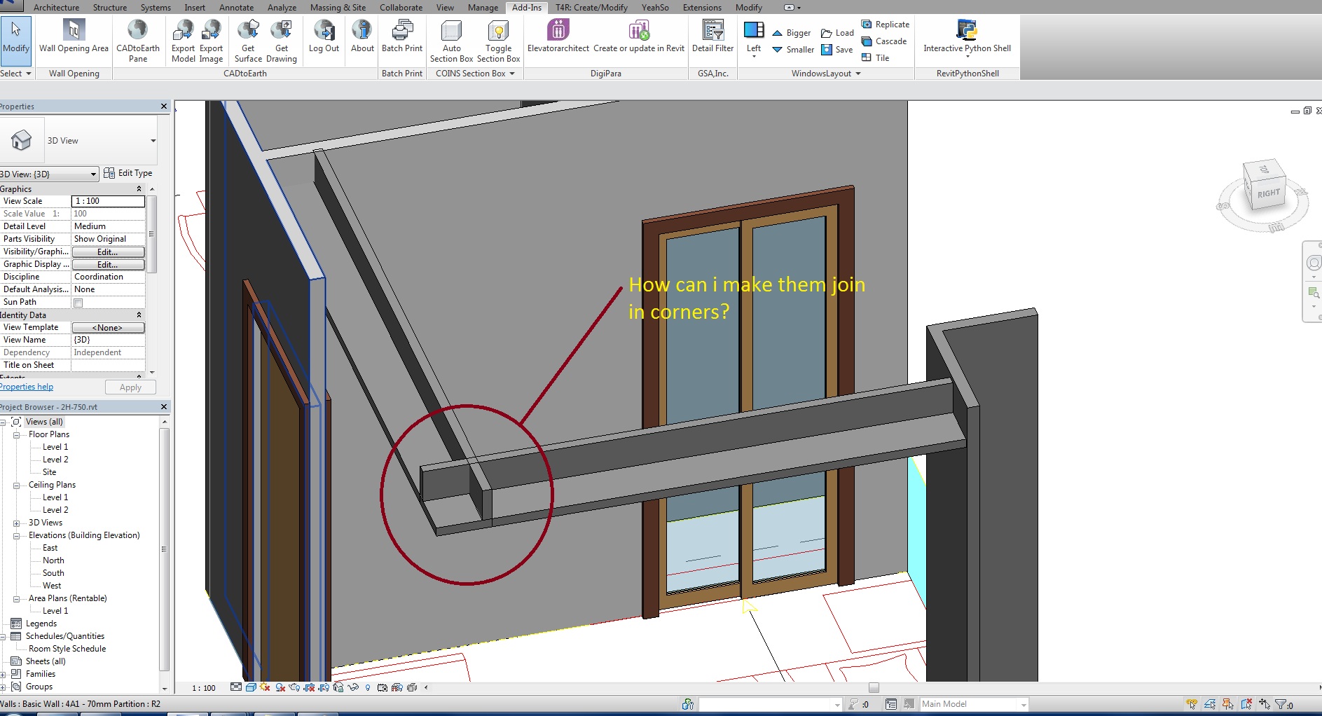

The issue is when creating the bulkhead with chain, it doesnt join the corners! any idea how to make it do so?
Or if you know a better default tool to create such thing, please let me know.
Thanks.

Create that with "In-Place" sweep
Thu, Jun 13, 2013 at 8:07:05 AM | Joining walls in line based family
Just create that profile and use an in-place sweep.  That will turn all corners and you can point to lines to create the path.

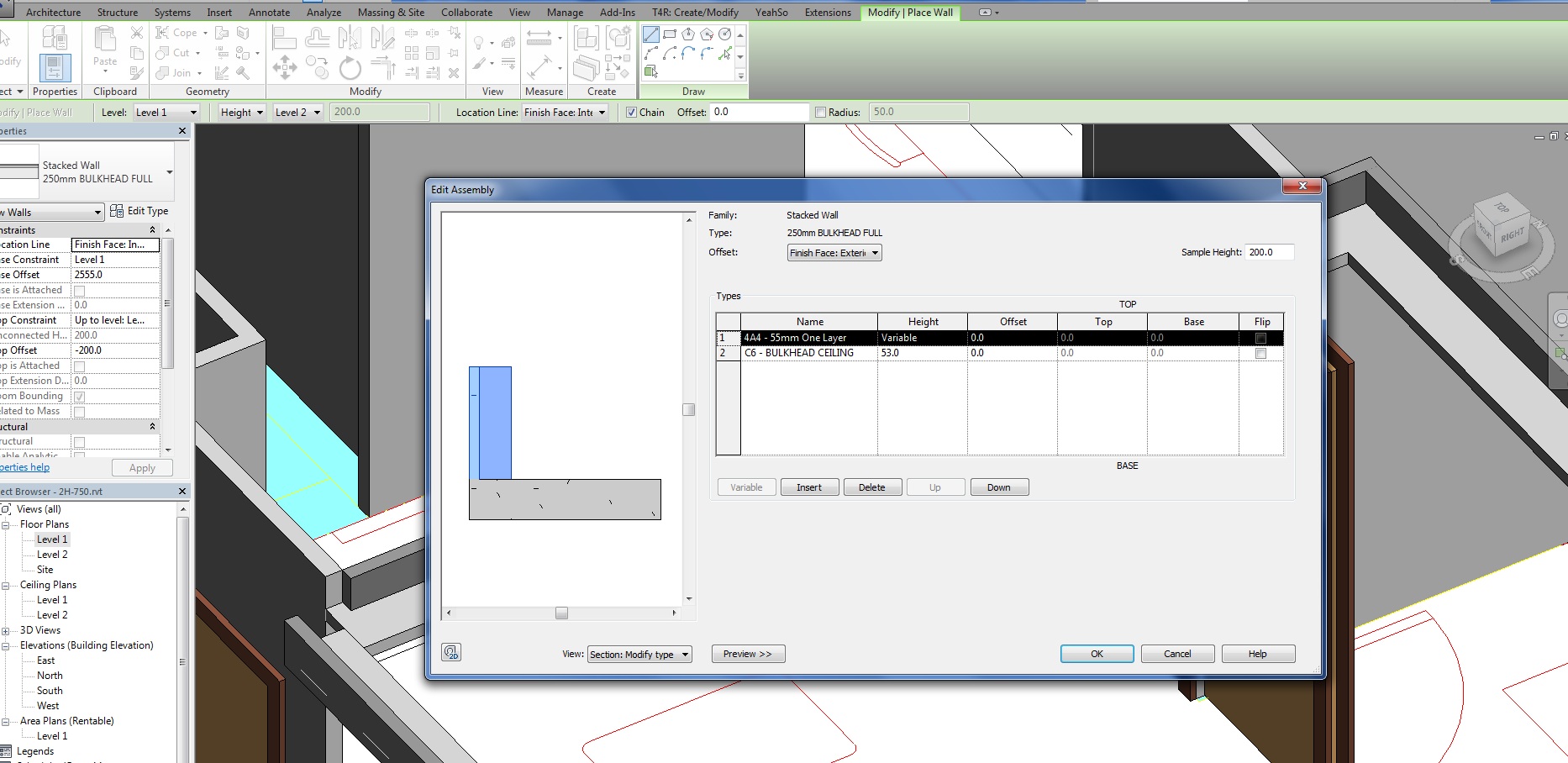

Thought they can be problematic in some cases, for creating bulkhead like things. I think stacked walls work quiet nicely.

"Coreed" you sir have lighten a bulp over my head!
in fact, I've created a tacked wall directly and tried it and it works, but the only problem is the joints with other walls!
It has really bad joint behavior, and fixing it with Revit is such a pain!

just select the ends and " Disallow Join"
