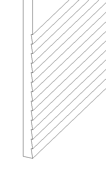

I have inserted a vinyl siding profile on my exterior walls, but it only shows them 3d when i select the wall. How do I get the wall to show up with the 3d vinyl siding?  also when I apply paint on the walls it only coats the interior side. How do I paint the exterior side?

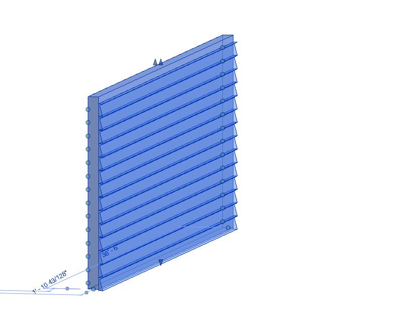

I am trying to create a 3d vinyl siding. Ive already created the wall structure, and when I click on a vinyl wall in the 3d view it shows correct.  However when I deselect the wall, the 3d sidding goes away back to 2d.  how do you get the 3d siding to be vissible in all views at all times?

ive already created the vinyl wall structure by using reveals. under the wall type properties>structure> reveals> add profile. i had to add the profile several times to create a wall of vinyl siding. after adding the profiles the vinyl wall was created.

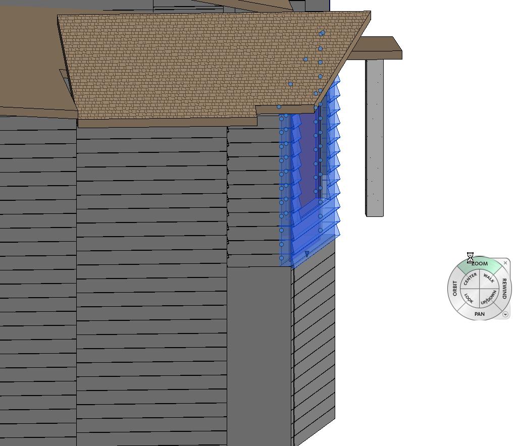

Obvoiuly something is flawed in your process.  Attached is mine done in a similar fashion Revit 13.  Maybe you have two walls in the same place.
I must caution you.  On small projects, this may work but in most cases, this will overwhelm your model and a material is a better process.

I made it to that point. No double walls. thanks for your effort
