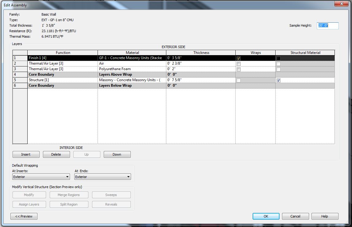

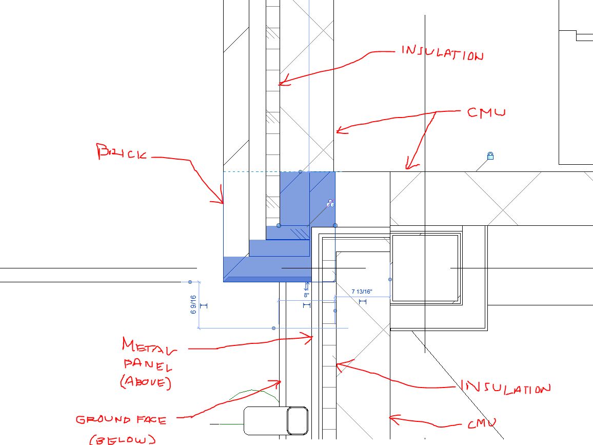

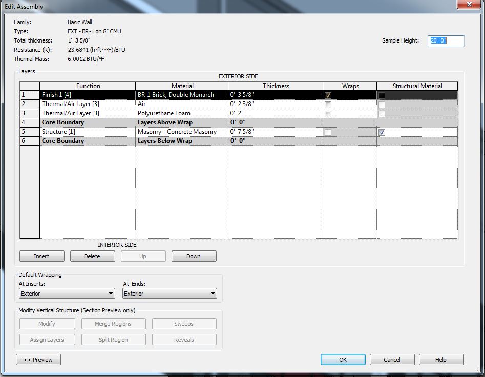

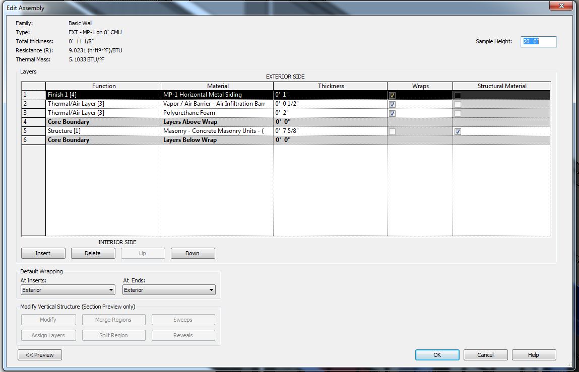

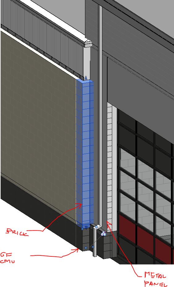

Hi, I'm working with 2013 and am curious to know how to have my walls clean up when there is only a slight shift (8") in the wall?  I'm currently showing a third wall (highlighted in blue) that creates the jog, but as 4 walls are coming together, no amount of join conditioning or grip-pulling seems to resolve the issue.  I am curious to know if it has something to do with the wall make-up which is why I've attached a few screen shots of the walls in question.  Any thoughts/guidance/help is of course appreciated!

Short returns are always a problem.
I would try turning off the wall join for the wall on the right. (Blue grip button for that wall - turn off join)

That's a pretty busy intersection with some short wall segments. I wouldn't get my hopes up on organically having REVIT clean this up without a little tweaking, 'edit cut profile', masking and disallowing joins, also 'corner joins' butt vs miter.
