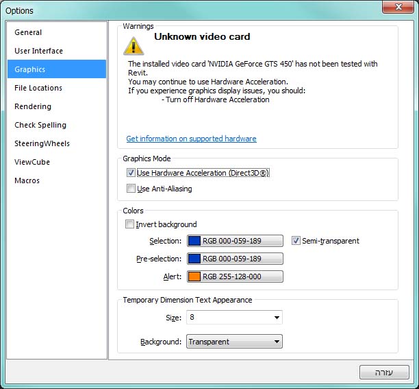

revit tells me that my video graphis is unknows
im working the HUGE project that moves very slowly
i have 18RAM
should i buy a new video card?

It's not over modeled, it's just dealing with a portion of the city while detailng a megastrutre inside it.
action like zooming in or change view or even just pan in 2d  mode is taking a lot of time
as u suggested beafore i splitted the project to workset.
but still, it moves slowly.
i have 18RAM and im going to change it to 24RAM soon,
my question is about the video card, i wonder what's that impact of "untested" video card (like mine GTS 450) has on revit
"UNKNOWN VIDEO CARD" Guidance Please ?
