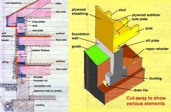

kind of like this, the way the grade is cut further back but I need to do it with each change in material.
Axonometric View labels and notes
