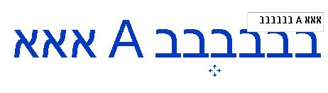

hi,
I am while i am tryng to insert right to left text (hebrew) in to a tag lable.
while I type I use the context manue to change reading order but when i finish typing it changes back.
I tried to manualy insert a unicode RTL control character from the context manu, but it doesent have any effect.
I hope I am missing somthing and its not a bug( entering long text (in hebrew) is criticle for notes and scheduals)
thanks
RAC 2014
win 7 64bit
Thu, Jun 6, 2013 at 9:38:44 AM | text unicode centrol caracter has no effect
sbll
Joined: Tue, Oct 16, 2012
2 Posts
it seems the problem only accurs in pramater lables and keynote lables. in regular text notes it works fine.when i open the keynote file in notpad it shows correctly but the label messes it up.in paramater lables: it seems like revit doesn't store the unicode RTL hidden character. (but then why does it work white regular text notes?)
