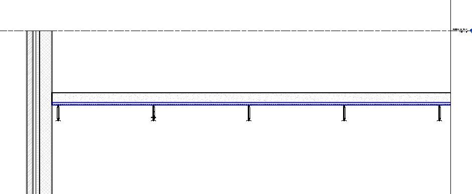

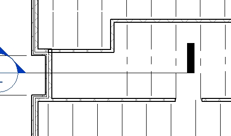

I am putting joists in and if the span is shorter than 10', they dissapear on the plan. They are still there in the model when I cut a section. Any ideas? I am not getting any errors  and I put them in using a beam system.

Joists are sloping... I have attached two screen shots. It seems to have something to do with the span of the joists, because some are showing up and some are not. They are all at the same slope.
You can see the joists are there in the section...

Are you sure they are at the same elevation? Attach an image of the section?
Mon, Jun 3, 2013 at 2:27:26 PM | Joist dissapears on plan but is there
Tea - the section is shown to the right.
sblake - show us an elevation section parallel to the joists that just shows two of them - the short one to the right and the l;onger one just to the right of that.  Include a line in the section to show where this plan's cut plane is.

I did attach the image of the section. They are on the same reference plane
