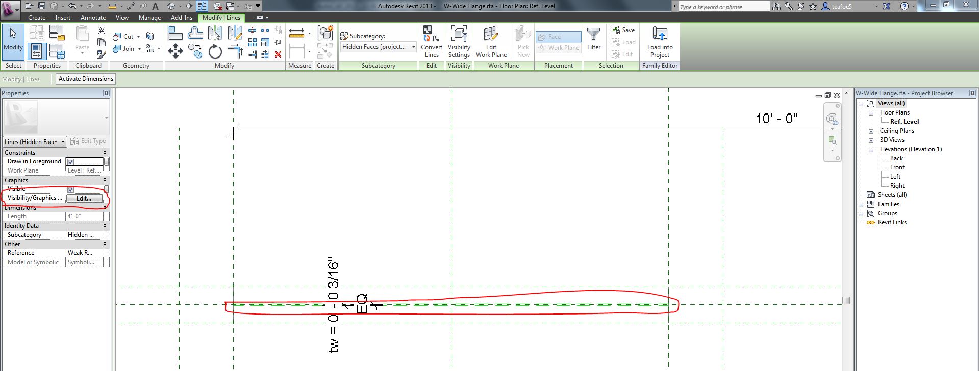

Can you show me a picture on how to select the symbolic line in a beam family ?
Fri, May 31, 2013 at 7:28:57 AM | Vertical bracing line
curtins1
Joined: Mon, May 20, 2013
10 Posts
do you have to draw a new symbolic line in the beam family ?
Fri, May 31, 2013 at 9:55:36 AM | Vertical bracing line
teafoe5
teafoe5 Avatar
Joined: Fri, Nov 12, 2010
1749 Posts
4 Stars: 47 Votes
The lime green lines are the symbolic lines.  These are already built in to the out of the box revit families (depening on what family you are using). If you created your own family you will need to add the symbolic lines.
