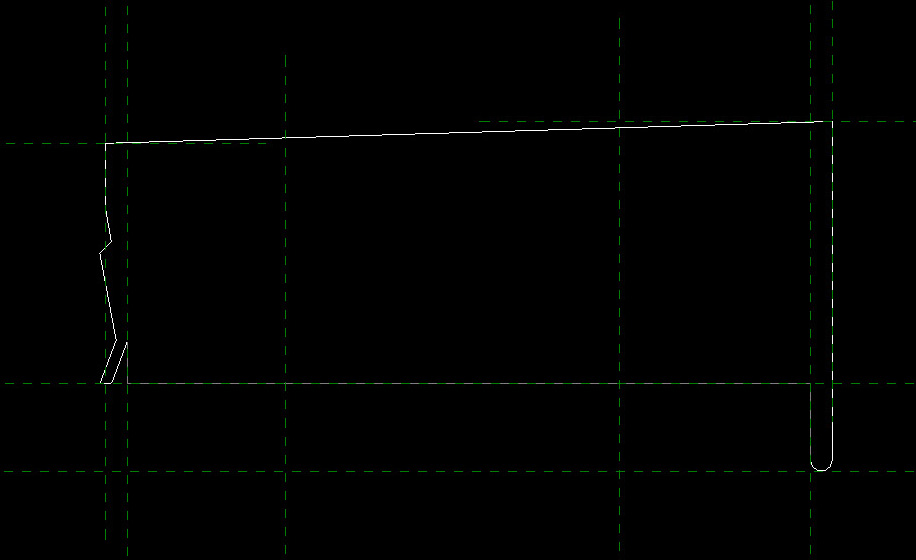

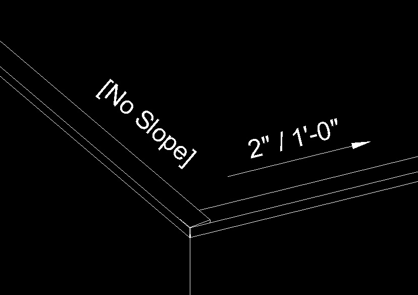

I am having trouble mitering a complex roof fascia (metal coping) at the corners of pitched roofs.  Attached are images of the fascia profile as well as the problem area.  I have seen some other threads on this issue but it appears that if the fascia is created in sequence the corners should automatically miter which they are not in my case.  Are there any other suggestions for how to fix this issue or reasons why this is not working properly?  Thanks!

Can you attach the profile family so I can see if it works for me?

File attached.  Thank you for looking into it.
Wed, May 29, 2013 at 1:23:20 PM | Sloped Roof Fascia
Your problem is caused by the angle between the roof edge and top.  That is not the same on the two edges - correct?
One side is 90 (the flat edge) and the other is angled.  That is why it will not miter correctly
