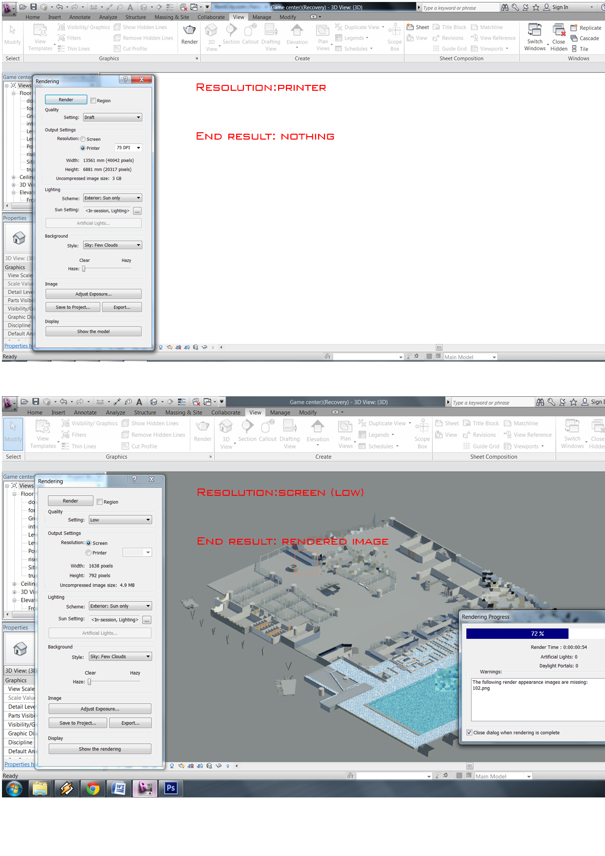

Hello. I have designed my building and what I wana do now is to show each floor in 3d view, smthg like isometric view. I m using section box to eliminate upper floors. The problem is that when I start rendering to printer the image becomes white, and the rendering takes few seconds. But if I m rendering to screen it can render. But I need to render to printer with higher resolution. Any suggestions? thanks in advance.
I m attaching jpeg: upper image shows rendered image when I set resolution to printer, and the lower shows it to screen

System?  Memory?  Which Revit?  All latest updates installed?

Windows 7(64 mb). revit 2012. But I m not aware about updates, do I need to constantly update my revit? I know this is a noob question..Buy the way I have 250 gb free space on disk C, which I think should be ok for rendering. Is it an update problem?

You should always pay attention to news about updates.  AutoDESK will continue to update a release until a new release is formalized.  I show my Release 12:
20110916_2132(x64)Update Release 2
You might have to turn off hardware acceleration.  Revit R pulldown / options / graphics.

Try to clean your TEMP folder, use "CCleaner" or similar software.
