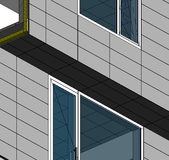

Hi,
I have a problem with Revit above the entrance door. The door cuts the floor above. I have added a picture of the problem. How can I solve it?Thanks for your help.Hamed
Mon, May 27, 2013 at 4:41:39 AM | Door cutting the floor above it
Joined: Tue, May 22, 2007
5921 Posts
4 Stars: 205 Votes
You have to edit that family and check if there is any VOID cutting that portion of wall...

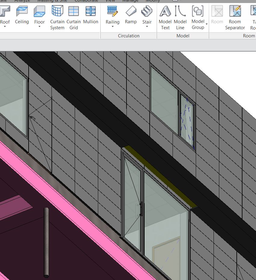

Hi Typhoon,
Thank you for your reaction. The problem was actually a wall sweep above de door family. I have replaced it wiht a geric model and as you can see it works.
