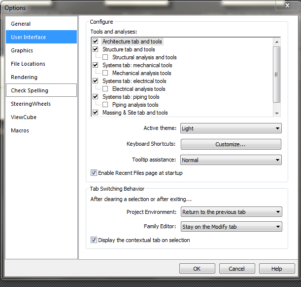

Wed, May 22, 2013 at 7:24:04 AM | Need Help with Revit Arch. 2013
Walls are a system family.  Create your own types by duplicating the type you have and defining new.
Doors, windows and columns can all be loaded from your library.
If you want to do architectural elements, make sure under the Revit R / Options tat you have the right tools loaded.  See attached.

i dont even have that tools and analases bar

Wed, May 22, 2013 at 9:20:41 AM | Need Help with Revit Arch. 2013
Click on the revit R in the upper left corner & pulldown to options then pick user interface.

User Menuteafoe5 even when i click wall theres only one that coms up Basic wall wall 1 no brick wall no Mstd wall interior wall
only thing i have is
active theme
keyboard shortrcuts
tooltip assistance
and the tab switching behavior
