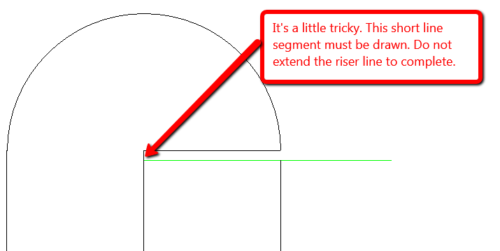

I am currently working on an As-built project which has a stair with the first tread that curves around.. Currently, I am using filled region to show it in floor plan. However, I'd like to know if Revit can do such stairs.
ps: I've included a screeshot of what I did.
Thanks!

You would create that first tread seperately from the rest of the stair.

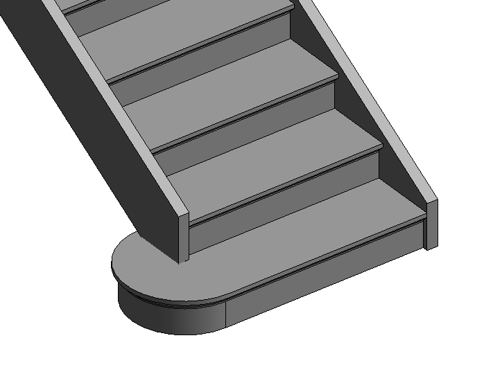

No need to sketch it seperately.  Just pull the boundry line bak to the second riser and add your riser line arc.  See attached.

Quoting WWHub from 2013-05-20 07:54:21
WWHub, what you show is not what's shown in the sketch. He wants to go back one more thread

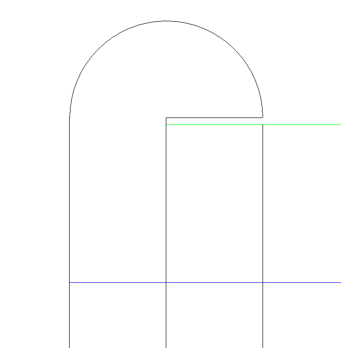

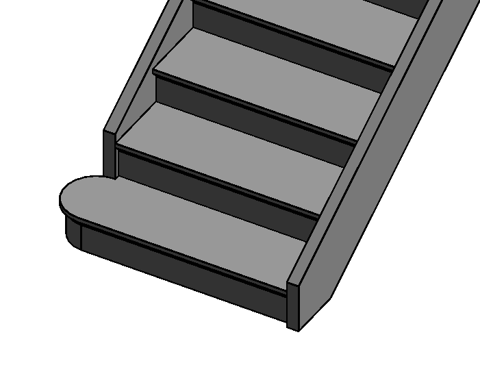

Mon, May 20, 2013 at 11:17:34 AM | Stair
Missed that ....
but basically still the same except the riser has to return along the stringer as I have done in the attached.
Mon, May 20, 2013 at 2:07:46 PM | Stair
coreed
coreed Avatar
Joined: Fri, Feb 10, 2006
1874 Posts
4 Stars: 16 Votes
o.k., that works.

Mon, May 20, 2013 at 11:25:24 PM | Stair
annateo301
Joined: Tue, Aug 4, 2009
70 Posts
Oh wow! That's not as complicated as I thought it would be..
