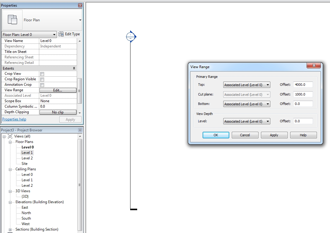

Hi,Every time when I place beams in a plan, I can't see them!I know the rules about the view range. I played a lot with it and also did a research at different forums to get an answer, but no results...I did also make a new project with new settings and new created custom beam family (with the Metric Structural Framing - Beams and Braces family in Revit folder).I can see the beams in 3D and sections, but never in the floorplans as it should be. If I enable an underlay, the beams appear very thin and grey, but that's not the intention...The beams also show up as it should be ONLY when the cut plane is set on height where the beams are. Also that's not the intention, because it will screw my drawing...Someone ever had the same problem? How to fix this?

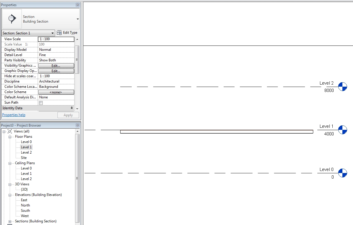

Look at the screenshots. I also did upload the .rvt file if you want to see it by yourself. I don't think I made a mistake, but you never know Smile

Setting up the viewrange to "unlimited" is giving other problems. when I do that I can see the beam, yes, but I also see things that I don't want to see. for example the walls of a level below. So, I don't think I can use this method Sad
I did use this one: http://www.screencast.com/t/TtRvmH116mz1
I don't think this is the right solution, but it works...
I'm very disappointed to Revit, because it's so smart and so strong, but still couldn't fix this stupid beam problem. For the time being I will use this method (see link). I hope in the future to find the RIGHT solution for this.If you think I did something wrong or if you have other tactics, please write down. I will try!

Hi David,
Maybe I have to explain it better. sorry for that...I understand you, but this is what I want to achieve:I want to draw architectural floorplans (level 0, 1, 2 and roof). Level 0 is for the shops, so there will be concrete columns with concrete beams on it for carrying the other levels (appartments).So, when I watch my level 0, I want to see the beams that are placed IN level 0 carrying the other appartments.My floor plan level 0 settings are: top view range is set just under the level 1 floor.
Cut plane at 1200 (level 0)Bottom view range at 0 (level 0)So, I don't need to set view depth, because I don't want to see anything other then this level. Also don't want to see any beams from level -1 or level 1.That's what I want. Am I clear enough now?
Thank you for your help,
Sef
