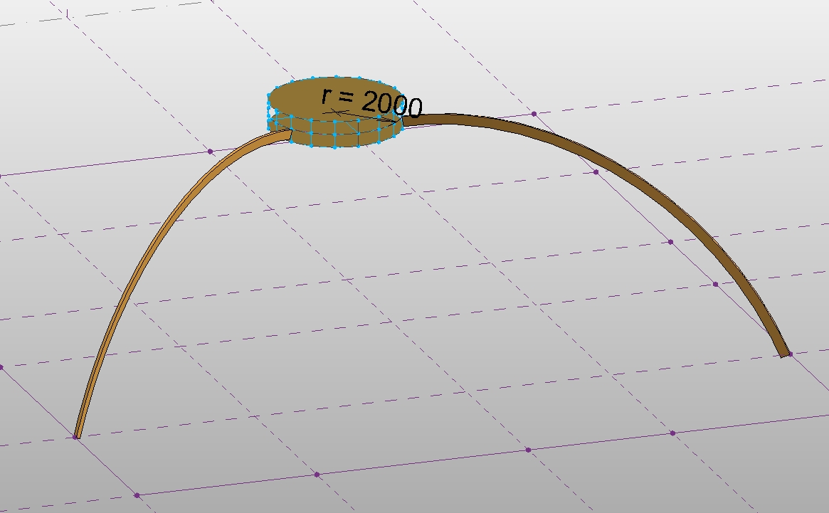

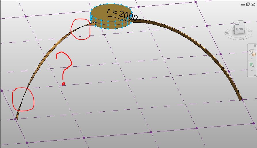

When I put a adaptive arch on a model the section is twisting, especially when I put it on the south side (picture). The orientation of the adaptive points is orthogonal on placement. Anyway, I tried every orientation for the adaptive points but in every cases the section was twisted or bended. What do I did wrong?

making arch with 2 points is very tricky.. direction of the shape in sweep is hard to control in this case.(it rotated depends on the location of adoptive points)
i recommand make 3 or more points in conceptual mass for placing adaptive family and also in adaptive family.(dont make arch in adaptive family..)

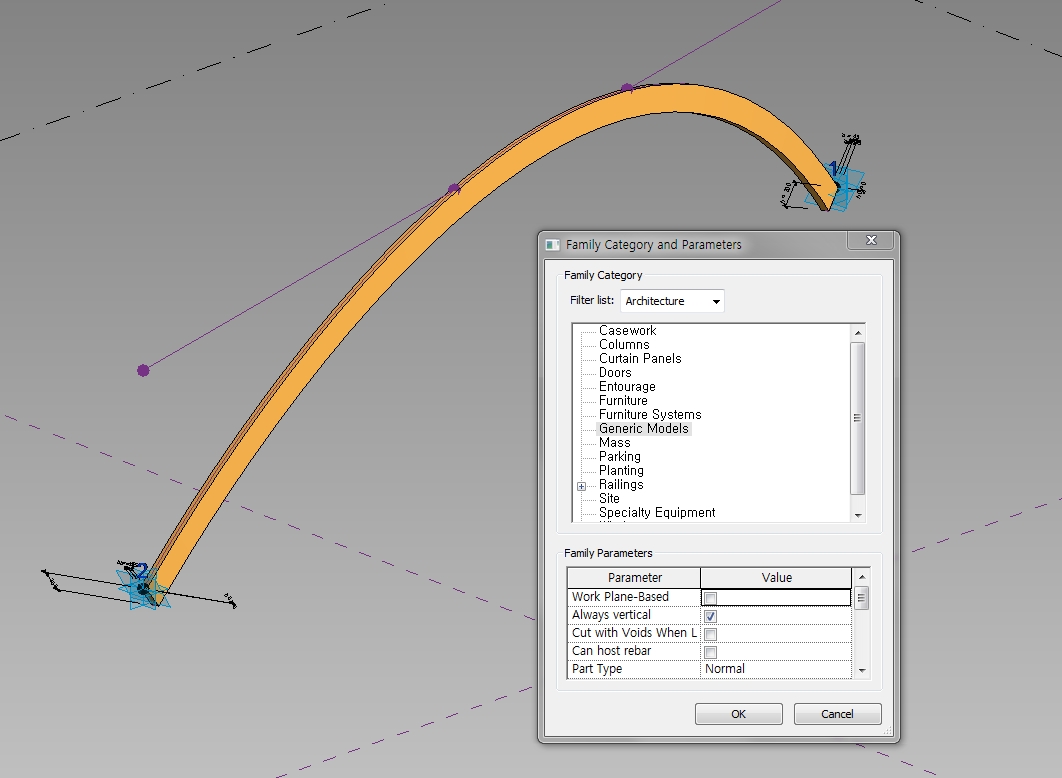

i just found what was wrong..
delete two profiles at the middle, and check family parameter 'always vertical)
see attatched images
hope not too late.

I solve that problem in other way at that time (I just create some beams in the main project who are following a curve), but still... that was something that put me wonder, so...thank you for the solution!
