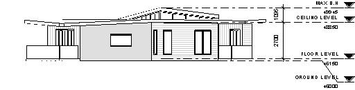

When i go to my elevations and also section views some lines are not visible untill i zoom in really close.
This is making it impossible for me to detail my work as needed.
I have my model continually in Hidden Line display and a detail of course.
The picture show my current view, with the roof lines dotted for some reason and the bottom left veranda floor line invisible.
If anyone could help, id be very greatful!

Could be a graphics card issue, try updating your driver.
