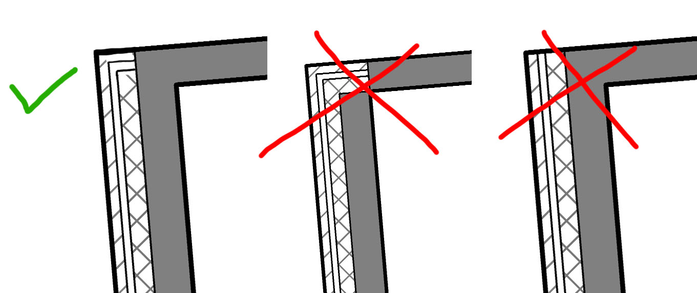

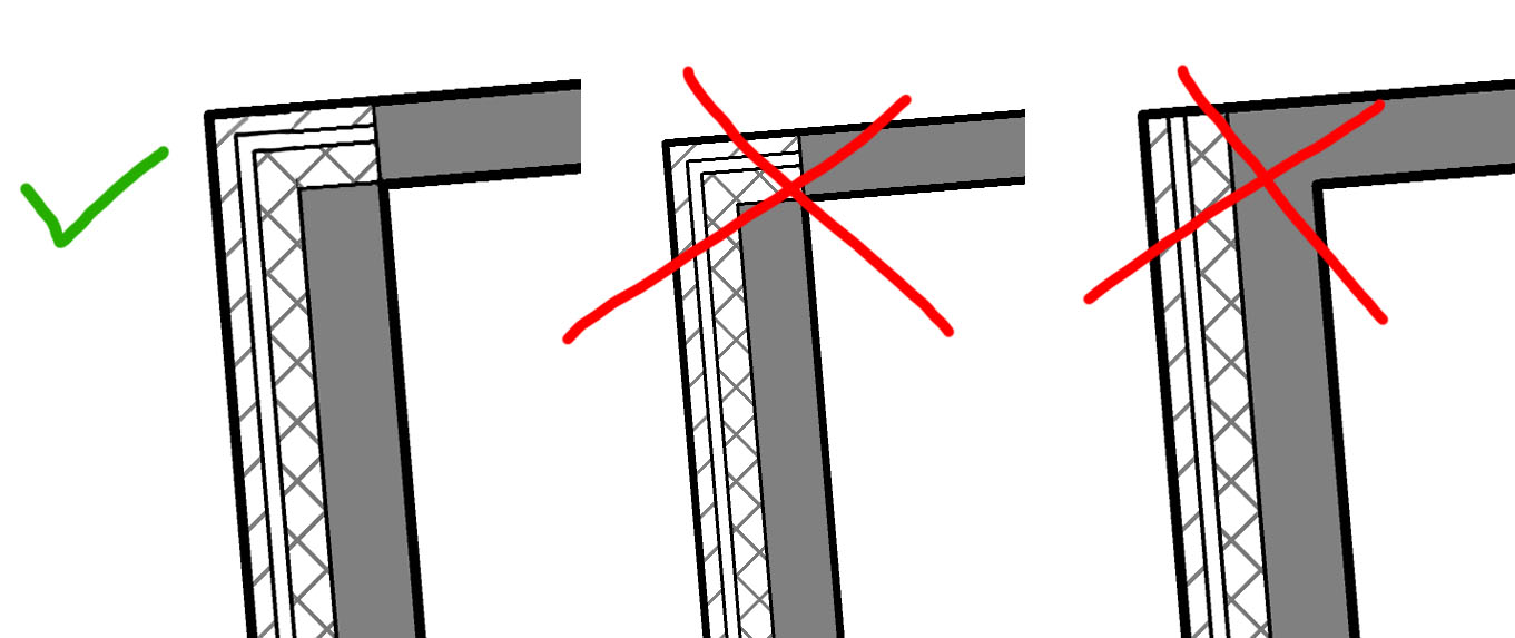

Hi,
Is it able to join 2 walls like this? -> see attachment .jpg please.I'm asking, because I can't do this in Revit. So I made it in pshop for showing an example.
I would appreciate if someone could help me.
THanks,

EDIT: attachment 1 is not correct. watch attachment 2.jpg pls.

Assuming the grey is the core, you will always get # 3 in a joined condition.  But if you have wrapping on and turn off the wall join on the blue butten at the end of the wall, you should get #1.

It's not possible to unjoin these 2 walls. I did attach the .rvt file (revit 2013).
they are still joined, wrap is on and the grey one is idd the core.
Tue, May 14, 2013 at 3:15:08 PM | wall joins
You are incorrect, you did not do what I told you to do.
I wrote"...turn off the wall join on the blue butten at the end of the wall."   Click on the wall then right click on the blue butten at the end of the wall.  Then click on "disallow join".

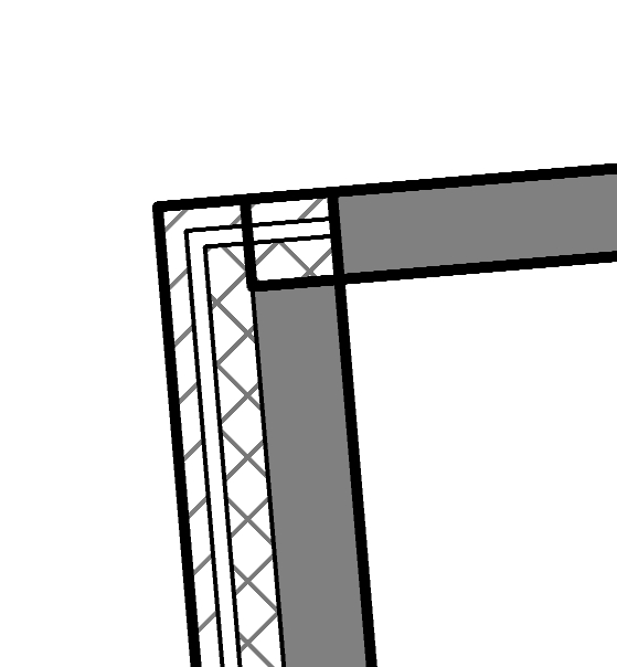

thank you, but actually it didn't work yet. I thought it was correct, but it did something else then it should be like the left image in my attachment....
I did select the brickwall > right mouse click on blue dot > disallow join > moved the end of the wall to the correct place and now I got this -->> see new attachment. Did I read it well for this time?
I tried to play with it afterwards, but didn't help yet...
