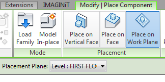

Tue, May 14, 2013 at 7:46:16 AM | Inputting fixtures
Do you have levels?
Are you paying attention to your settings? ... see image

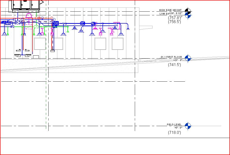

I attached a picture of a sectional view of my floor plan. I am paying attention to my settings but even after trying all of the settings detailed in your picture i still can not add fixtures properly. I attempted to set up a reference and a work plane but it still deosnt work as it should.

Your not really telling me much.  What fixtures?  I see a lot of elements that you obviously do have.  Please don't make us guess.
Our floor mounted fixtures work fine.  So what are you using?  Something you made?  Something you found somewhere else?  A regular MEP fixture?   If it is face based and there is no face - then you will have a problem.

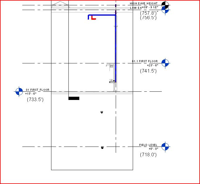

Tue, May 14, 2013 at 12:14:30 PM | Inputting fixtures

So i think i have narrowed down my issues to level heights.
the levels in the drawing were set up by the arch. I placed a floor drain on level one and level two and from the picture attached you can see that these levels are not corresponding with the floor height.
I attempted to create my own work plane but I am still having difficultities with it.
Does it sound like i am on the right path?
Tue, May 14, 2013 at 12:19:00 PM | Inputting fixtures
#11
"....Does it sound like i am on the right path?..."   No.
Copy monitor the architect's levels then create your floor plan from the appropriate level using the view / plan process.  Levels ARE reference planes already so don't mess around creating different ones.

Assuming it is an element you can't copy monitor and just as an example, in a floor plan, for floor mounted toilets, place your toilet in the right orientation anywhere close.  Align and lock the toilet to the architect's model using the families location planes (usually in the center).  Now in VG, under the linked models, change the VG of the architect's link to turn off plumbing.
