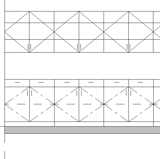

I wanted to make the cabinets we use in Revit show up the way my boss likes them in the elevations . . . the attached image shows that I got the lower cabinets to work, and I SWEAR I did the upper cabinets the same way but they lines are not showing up right!  I even deleted the symbolic lines and put them in again . . . still not right.
Any suggestions?  also attached upper cabinet file.

Go into your project and under Manage>Additional Settings go to line styles and make sure the line pattern is correct for the line style.
It works fine in a new project for me.
