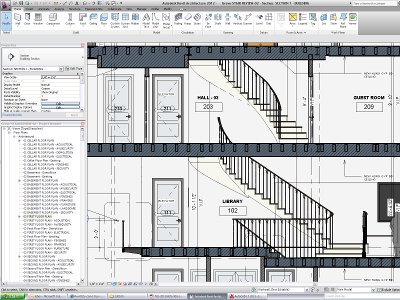

Revit 2012.  Curved monolithic stair.  Second floor works great.  First floor has this kink in the run.  It seems to be a problem with the turn at the bottom.  When I remove the treads that turn back towards the stair and just draw them straight the kink goes away.  Anybody have a whiff of why this might be?  Pictures attached for your enjoyment.  Gracias.

in curved stairs, angles between each treads must be all equal and all virtual extension lines of treads must across at one point that center of stair curve, to maintain bottom clean and smooth..
So check this and make them correct if not.

I don't believe dingohot understood your question.
Please post a better image so we can see what you are talking about.

Thanks dingohot.  I fixed that issue by separating the landing and short run at the botttom and the main run into two separate stairs.  However, your point is well taken as I've often found that despite my nashing of teeth,  it usually is user error.  Thanks for your help.
